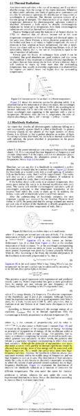

I don't understand the first statement in red. I believe that modes are distinct frequencies. How come most of the modes are in higher frequencies. The equal number of modes could be in low frequencies too. There might even be radio waves. Please have read the highlighted part in this text: http://imageshack.com/a/img924/7230/jFDaZK.jpg. I have attaching the image as an attachment too but not sure it would show up clearly. Even this text says that most of the energy is contained in high frequencies without really explaining the reason, at least as I see it. Please guide me.
I think that the second statement in red means that the number of vibrators (atoms) emitting an electromagnetic wave of certain frequency is proportional to the square of the frequency. Do I have it right?

  • Figure 2.1 handwritten-style plot of blackbody spectral energy density against wavelength, showing a curve that rises to a peak and falls, with labelled axes and an arrow marking the Rayleigh-Jeans region at long wavelength.

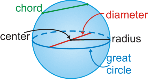

Why do the EM standing waves need to have nodes at the inside surface of metallic sphere? The following is one of the webpages.
"Electromagnetic standing waves in a cavity at equilibrium with its surroundings cannot take just any path. They must satisfy the wave equation in three dimensions. The solution to the wave equation must give zero amplitude at the walls, since a non-zero value would dissipate energy and violate our supposition of equilibrium."

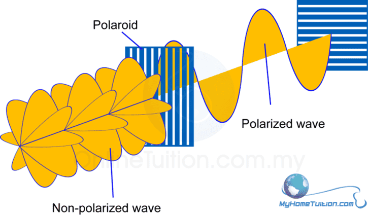

There should be some reason that the surface only allows those EM standing waves which can have nodes at the surface and others, like radio waves having wavelength in km, which couldn't fit the nodes are not permitted.In a metallic hollow sphere, EM standing waves don't need to pass the center of sphere, or do they? I mean that there could be some standing waves along the chords of sphere and not along the diameter. Please have a look here if what I'm saying is not clear.
Further, any EM standing wave could be oriented along so many planes like unpolarized light waves. So, is this how each standing wave is oriented along so many planes in a hollow metallic sphere blackbody radiator?

  • Diagram of a blue sphere showing a green chord, a red diameter through the center, a black radius, and a blue dashed-and-solid great circle, with labels pointing to each.
  • Diagram of a non-polarized wave, shown as many yellow oscillations pointing in different directions, passing through a vertical-slit Polaroid filter and emerging as a polarized wave with a single oscillation direction.
Because they are Standing Waves. That's a definition. You can argue about how valid the main assumption is but that was modified and dealt with years ago by Planck.
You have skipped half way into the reasoning that was used by Rayleigh / Jeans and should really start at the beginning if you want to have a valid opinion.
