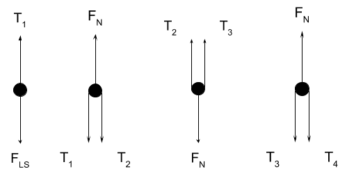

Hi.
First of all i have a question regarding a simple Atwood's machine. The pulley has no mass and the string has no mass and is inextensible. If one pulley is suspended from a fixed support and it has 2 masses ; one at either end of the string. If i construct a free-body diagram of the pulley it has 2 forces directed upwards , both being the tension T. So as the pulley does not move , that means there must be a force of 2T acting downwards which is the force that the pulley exerts on the fixed support. If the pulley is suspended by a string , shouldn't the tension 2T be acting upwards ?
If the string suspending the pulley is now cut and the system goes into free-fall ; what does the free-body diagram look like for the massless pulley ?I have that the tension T is now zero so there are no forces acting upwards , but the pulley has no mass so has no weight. So , there are no forces on it , yet it is accelerating downwards ?
Tension, and likewise compression, is best thought of as a pair of equal and opposite forces. Tension T in each section of the lower string will act upwards on its attached weight and downwards on the pulley. The tension 2T in the top string acts upwards on the pulley, etc.
More generally, you may have a string with mass, so gravity or some other acceleration may lead to changes in tension along the string.
This is incorrect. Why do you think that?

No, if you construct a free diagram of the pulley, the two tensions from the string supporting the masses will be downwards, i.e. away from the pulley as shown in th diagrams posted above by @Lnewqban.
Yes it should. That is consistent with the downward forces exerted by the two tensions as pointed out above.

The massless pulley is an idealization so that you can ignore its moment of inertia and hence its angular acceleration. If the moment of inertia of the pulley divided by the square of its radius (a.k.a. its effective mass) is much smaller than either of the hanging masses, the effect of the pulley on the acceleration may be ignored. However, this is an approximation which becomes inappropriate when the upper string is cut because the pulley's mass in free fall will have an acceleration equal to ##g##, the same as the larger masses.

I was wrong. The diagram in #3 was great and pointed out where i was wrong. Thanks for everyone's replies.
I have one last question ; it specifically refers to Introduction to Classical Mechanics : with Problem and Solutions by David Morin. At the bottom of P58 it states that the tension in the short string connected to m2 is 2T because there must be zero net force on the massless right pulley otherwise it would have infinite acceleration. But on P59 the acceleration of m2 is calculated which means that m2 and thus the right hand pulley is accelerating with a finite acceleration. I'm confused !
