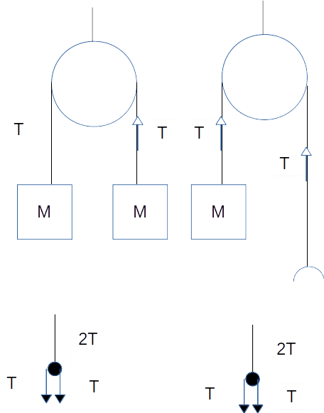

I have to apologize if the diagram is awful: I drew it for the sake of asking... I am analyzing the rope that is hanging the pulleys. From the diagram, the pulley at the left (let's call it L), has two objects with mass M at both ends. The pulley at the right (let's call it R), has an object with mass M at one end, while the other end is fixed. By analyzing the tension, we see that the tension add up together as shown in the free body diagram below, as they are in equilibrium, ##a=0## and ##T=M g##. Thus the rope that hangs pulley L and R both exert the same tension. Is this correct? It seems counterintuitive to me, that you can use 1 object to give the same tension on the rope as you could with 2 objects. Thanks in advance.

yucheng said:
Summary:: The pulleys seem different at first glance, however the tension of the rope that hangs the pulley is the same. It is counterintuitive, that's why I'm asking.
well yes the systems seem to be equivalent (equivalent in terms of the tensions of the ropes) but in static equilibrium only. One system can start to move (if we give a small nudge in one of the masses in the left pulley system) but the other system cannot move (if we give a nudge towards down to the mass in the right pulley, then the Tension will increase and it will prevent the mass from moving.)
Btw, I think you use two objects in both cases, in the right pulley the second object is where you fix the end of rope and it is essentially the whole planet earth!
When pulling the pulley up:
Pulley 1 has no mechanical advantage. You pull the total weight and the masses move the same distance that you pull.
Pulley 2 has mechanical advantage. You pull 2x the total weight and the mass moves 2x the distance that you pull.

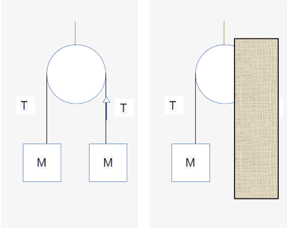

If it is counter-intuitive, then you might consider informing your intuition. Look at the figure below. On the left you see a pulley with two equal masses. On the right you see an identical pulley with its right side hidden by a screen. The pulleys are not accelerating.
Question: Can you tell whether behind the screen there is a hand holding the other end of the string or another hanging mass equal to the one on the left? If you cannot tell the difference, then the tensions in the two figures have to be the same.
