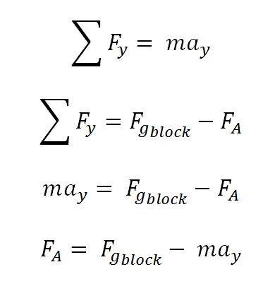

I'm unable to scan my work onto the computer, but I've gotten to the part where I this equation:
ay = \frac{F<sub>A</sub> - F<sub>g<sub>block</sub></sub>}{m<sub>A</sub> + m<sub>block</sub>}
The problem is now, I have two unknowns ... FA and mA. This is where I'm stuck and I don't know if I missing something from before or ...
By the way, this is a question from the 2011 OAPT Physics Contest.
You are in a position to draw the FBD for the mass. Write the equation for the acceleration of the mass assuming some tension T is acting in the rope. You're given the acceleration, so T is...?
This is the work that I have.

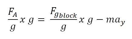

I'm stuck here because the m in the equation is for the total mass of the system, but I don't have it. I tried doing something like:
but you still need to know FA to get the mass, so I don't know what I'm doing wrong :(
The only mass that's moving is the one that's hanging on the rope. You have its weight.
Ok, I solved it --> FA = 125N.

No, you are forgetting that the block accelerates upward.
Is the answer wrong or are you just being picky about no direction when I state my force vector?
Your answer is incorrect.
Oops, I think I messed up a sign in my analysis somewhere. I re-did it, hopefully this is the right answer:
yes.
