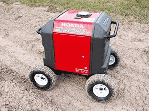

It sounds like this is no different from a gas-powered generator in such a wagon, no? I would just read the safety manual from a typical generator to see how they handle the output ground connections to their multiple 3-prong AC Mains power outlets...
Red and black Honda portable inverter generator with the model label EU3000i, mounted on a black wheel kit with two large pneumatic tires, standing on dirt ground.
https://generatorpowersource.com/wheel-kits-for-portable-generators/

Thanks for your input. It’s a bit different (I think), in that the battery negative is the ground, in the absence of a sustantial chassis ground. I’m leery of creating a negative loop in the place of a true “chassis” and its accompanying surface area.
