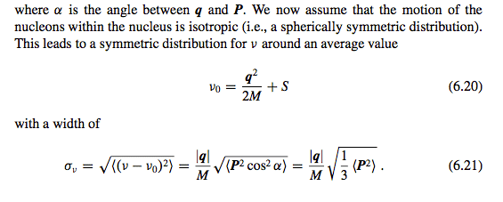

I'm particle physics at the moment and I don't get why the average value of cosˆ2 is 1/3.
The section :
Printed text with equations (6.20) and (6.21): v0 = q^2/(2M) + S, and sigma_v = sqrt(<(v - v0)^2>) = |q|/M sqrt(<P^2 cos^2 alpha>) = |q|/M sqrt((1/3)<P^2>).
My solution is :
[tex]< cos^{2}(\alpha)> = \frac{1}{\pi - 0} \int_{0}^{\pi } cos^{2}(\alpha)sin(\alpha)d\alpha[/tex]
I substitute
[tex]u = cos(\alpha)[/tex]
so i get
[tex]-\frac{1}{\pi}\int_{1}^{-1}u^{2}du = \frac{2}{3\pi}[/tex]
What I am i doing wrong ? :(

$$\langle \cos^2(\alpha) \rangle =
\frac{\int_0^{\pi} \cos^2(\alpha) \sin(\alpha) \, d \alpha}{\int_0^{\pi} 1 \cdot \sin(\alpha) \, d \alpha}. $$
To compute an average like ##\langle f(x) \rangle = \int w(x) f(x) dx,## you need the "weight" function ##w(x) \geq 0## to integrate to 1.
Thank you ! Makes sense!
