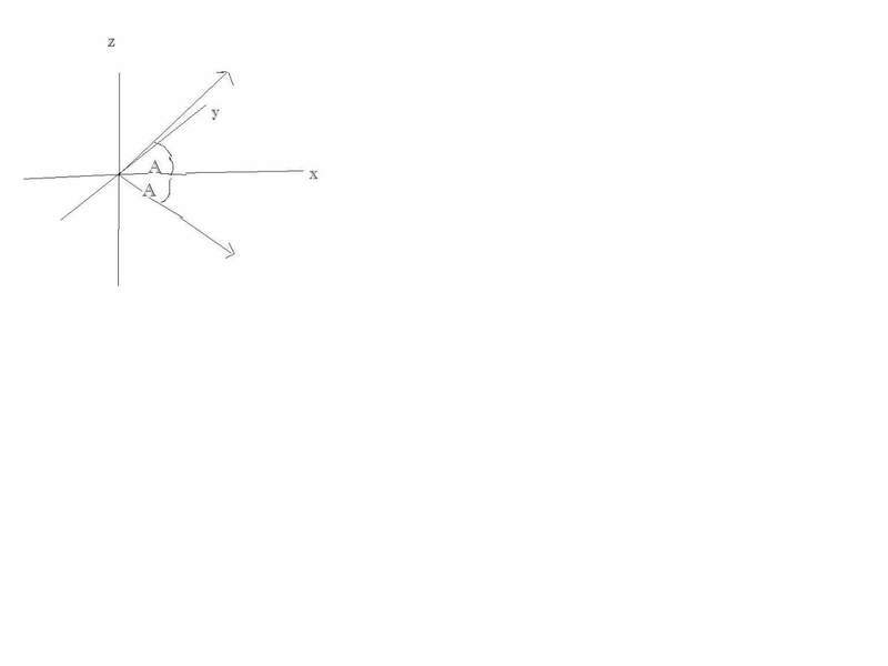

For a 3x3 orthogonal matrix with determinant= -1 (which means rotation followed by simple reflection), is the axis of rotation the same as the plane of reflection ?
My reasoning is follows (see attachment)
Say you have two vectors with the same angle size (which i call A), same x-values, but one of the z-values (height in this case), is the negative of the other (n.b. y-value is zero in both vectors )
Vector 1 rotates around the x-axis by 2A to get to the same spot as vector 2. Because the angle size is the same and because the z-component of vector 2 is the negative of the z-component of vector 1, we get a reflection ?
Since the "reflection" happens about the x-axis, this is why the plane of reflection is the same as the axis of rotation in the case of a 3x3 orthogonal matrix having determinant 1 ?

if [itex]A\in \textrm{O}(3,\mathbb{R})[/itex] and [itex]\det(A)=-1[/itex], there exists a [itex]U\in \textrm{SU}(3)[/itex] such that
[tex] UAU^{\dagger} = \left(\begin{array}{ccc}<br /> -1 & 0 & 0 \\<br /> 0 & e^{i\theta} & 0 \\<br /> 0 & 0 & e^{-i\theta} \\<br /> \end{array}\right)[/tex]
with some [itex]\theta\in\mathbb{R}[/itex].
Then there exists a [itex]V\in \textrm{SU}(2)[/itex] such that
[tex] V\left(\begin{array}{cc}<br /> e^{i\theta} & 0 \\<br /> 0 & e^{-i\theta} \\<br /> \end{array}\right)V^{\dagger}<br /> = \left(\begin{array}{cc}<br /> \cos(\theta) & -\sin(\theta) \\<br /> \sin(\theta) & \cos(\theta) \\<br /> \end{array}\right)[/tex]
So if you define
[tex] W = \left(\begin{array}{cc}<br /> 1 & 0 \\<br /> 0 & V \\<br /> \end{array}\right)U[/tex]
then [itex]WAW^{\dagger}[/itex] will be of such form that reflection and rotation are clearly carried out with respect to the same axis. Only problem is that [itex]W[/itex] doesn't necessarily have only real entries. How to prove that [itex]W[/itex] is necessarily proportional to a real matrix?
