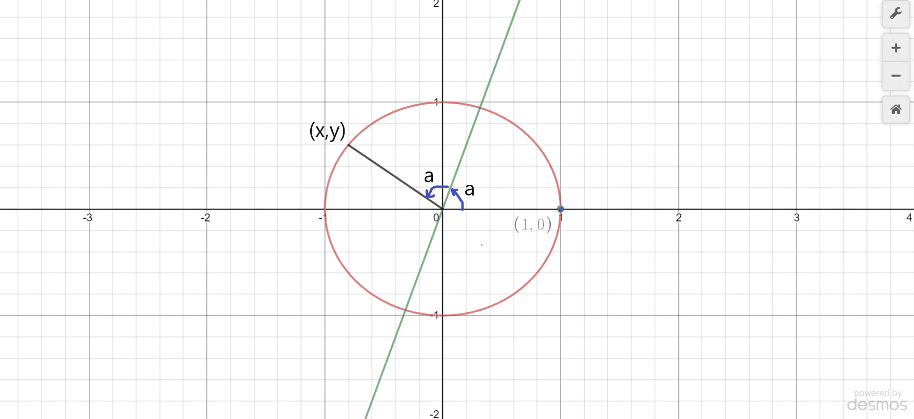

  1. For $\sigma_a\begin{pmatrix} 1\\ 0\end{pmatrix}$ we do the following:
    We draw an unit circle that goes through the point $(1,0)$.
    $a$ is the angle between the x-axis and the line, say $g$. From that line $g$ we draw a line such that the angle between these two lines is equal to $a$. The intersection point of that line and the unit circle is the desired image point $(x,y)$.
    We have a rotation around the origin by $a+a=2a$.
    We calculate the coordinates of the image point using the rotation matrix \begin{equation*}\begin{pmatrix}\cos (2a) & -\sin (2a) \\ \sin (2a)& \cos (2a)\end{pmatrix}\begin{pmatrix} 1\\ 0\end{pmatrix}=\begin{pmatrix} \cos (2a)\\ \sin (2a)\end{pmatrix}\end{equation*}

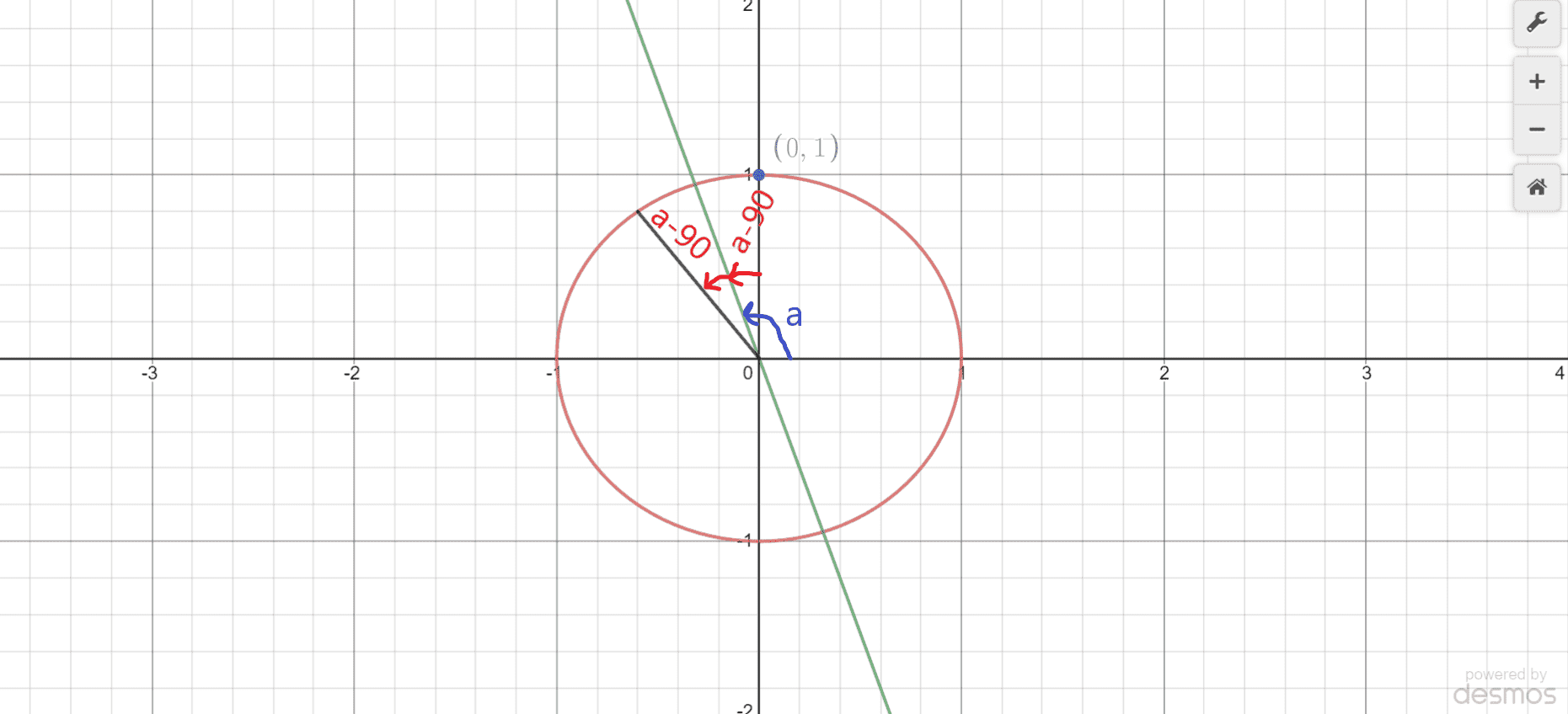

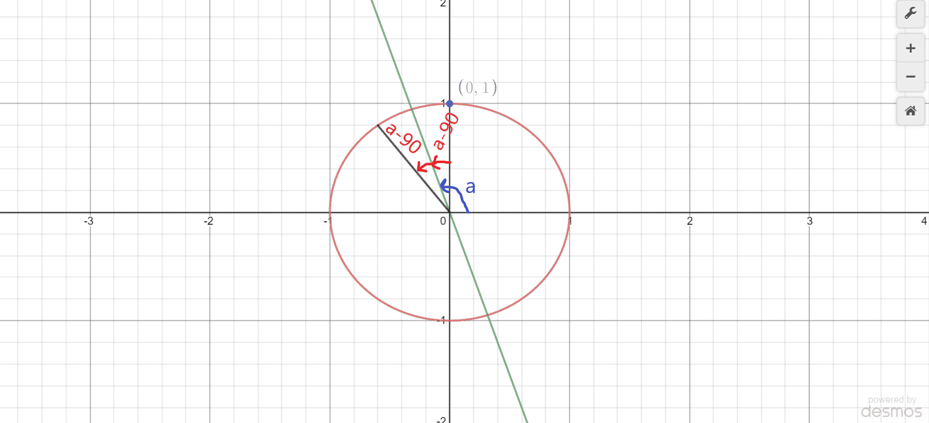

    For $\sigma_a\begin{pmatrix} 0\\ 1\end{pmatrix}$ do we consider the following graph:

Hey mathmari!
I think we are not supposed to use the matrix. (Worried)
Aren't we supposed to find the matrix as the last part of the question?
Instead we can find the image geometrically.
That is, we can draw the unit circle and read off the x- and y-coordinates of the image, which are the cosine respectively the sine of the angle of $2a$ in the picture.
Alternatively we can draw a right triangle and find those coordinates with trigonometry.
From your picture we can see that the coordinates are $(\cos(2a),\sin(2a))$.
It corresponds to the point $(\cos t,\sin t)$ in the picture of the unit circle.
Since it is the image of $(1,0)$, it follows that it must be the first column in the matrix $M(\sigma_a)$. (Thinking)
Yes.
We can find the image of (0,1) from it, which will be the second column of the matrix $M(\sigma_a)$. (Thinking)

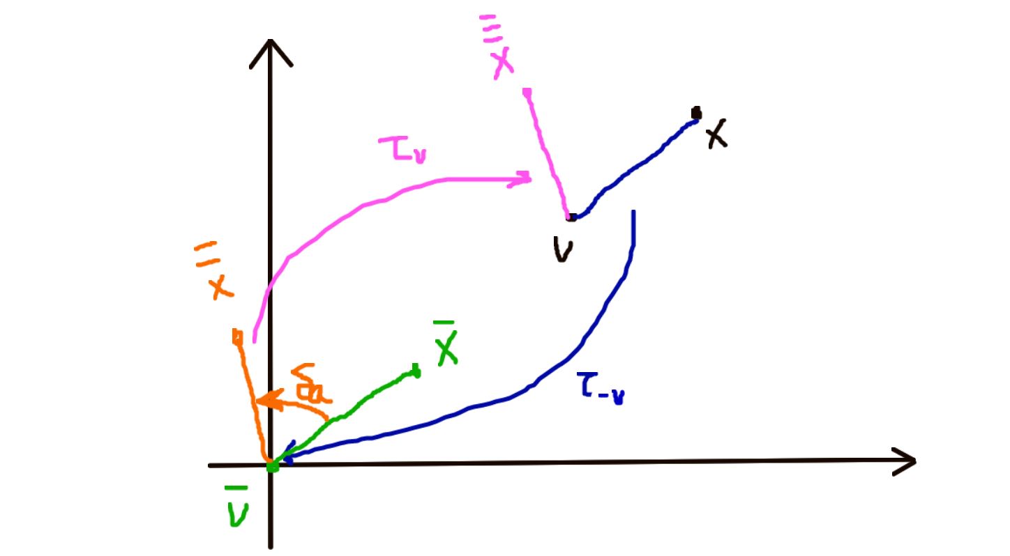

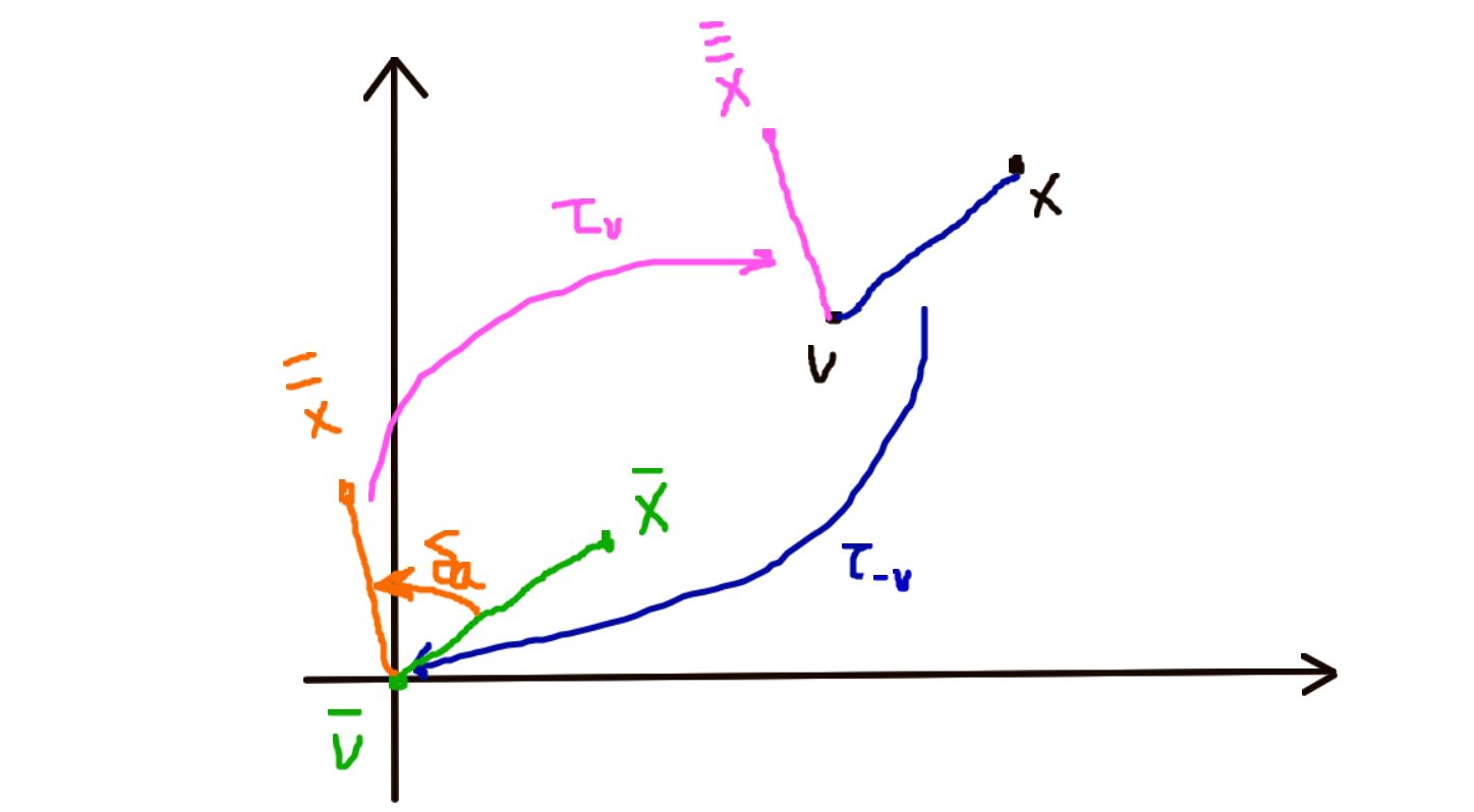

Do we draw the following graph for that?
(Wondering)

That is the intended graph yes. (Nod)
