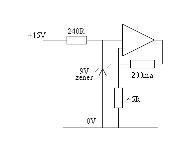

The only distinction between the straight 1 ohm resistor, I exampled, and the zener setup is that in the zener case the 1 ohm resistor is the sum of r_bias + R_z.
Also V_ref occurs at the junction of R_bias and R_z.
I don't see what is so difficult with this concept :confused:
And yes, it works this way in practice.

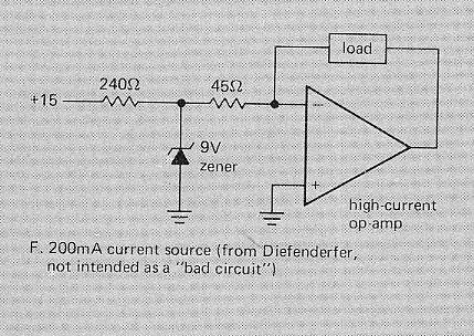

Hey berkeman, is it too early to sum up the problems we were having with the current source op-amps?
Not at all. Would you do that for us please? (You understand them, I'm pretty sure.) Please leave out the Zener power dissipation issues right now, though. NoTime and I are using SPICE simulations to resolve the disagreements via PMs.

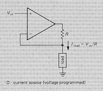

Voltage-controlled current source and 200mA "current source" - solutions
Wrapping up the possible problems with the circuits in post #74; circuits D and F.
Circuit D - Voltage-controlled current source
*The solution for this one is pretty simple. We need to swap the positions of the resistor and the load. D won't work because the opamp is supposed to be operating in a linear mode, but its two inputs are different voltages[1]. With the circuit we'd want to fix it by having R connected to the inverting input to ground. And have the load connected to R and the output of the op-amp.
Circuit F - 200mA "current source"
*Pushing 200mA of current through the zener may be a bad idea. The original configuration of circuit F does just this. As a fix for this problem, we could use the topology in the fixed circuit D. It would be best to have the zener be used as a voltage reference (to the non-inverting input) and have the load hooked up to the inverting input - circuit F fixed. This fixed version uses negative feedback, meaning that we would have the zener reference voltage at the inverting input - remember one of the golden rules of op-amps as outlined in the Art of Electronics - the op-amp's output will attempt to do what it can to bring the voltage differential between the two inputs to zero (provided we use negative feedback; see chapter 4 for more discussion on this). So if we use R to be 45ohms, we'd have a current of 200mA thru the load. IN this configuration we don't have to worry about excess current thru the zener because we are using the resistor to get the appropriate zener current for voltage regulation.
*Even with the fix mentioned above, we still have problems because we are dealing with real op-amps here i.e. non-ideal. 200mA is a lot of output current to ask from a general purpose op-amp.
*Next we have the issue of unbalanced input impedances. Remember that we have input bias current. Due to unmatched impedances on both op-amp inputs, we'll have some error introduced. In addition to matching the impedances, we could use an op-amp with very little input bias current (BJT input stage) or very little leakage current (FET input stage).
