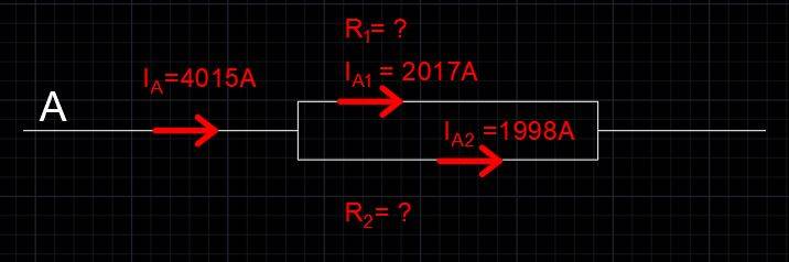

Right now, this is what I have measured (just looking at A phase):
IA1 = 2017A
IA2 = 1998A
IA was not measured - it's just a sum of the parallel currents.
My end goal is to determine if the imbalance between IA1 and IA2 is a result of the difference between resistances R1 and R2.
I plan on measuring R1 and R2.
If R1 = R2, then I can conclude that the imbalance is a result of something other than resistance (ie. inductive reactance from A itself or adjacent phases).
If R1 not= R2, then I can use the equation you shared to calculate R and X for each parallel path and for the complete circuit.
Schematic of two parallel branches between a line A and its return, labelled IA = 4015A, IA1 = 2017A on the upper branch and IA2 = 1998A on the lower branch, with R1 = ? and R2 = ? marked on each branch and red arrows showing current direction.
Let's table the fact that the example I have above is within 1% error for now. I know am splitting hairs in this example. Other ones the difference is over 5% so a little more substantial.
Not a simple algebraic sum if this is an AC problem and there is a phase difference between the currents. Otherwise this stipulation implies that the branch impedances can be treated like resistances (although they could be any complex impedance as long as the phase shift is the same for each).
Remember the triangle inequality for complex numbers ##|a| + |b| \geq |a+b| ##.
In general, this is called a current divider problem, and it goes like this:
Let's name the two branch impedances ##Z_{A1}## and ##Z_{A2}##.
Then the parallel combination ##Z_A = Z_{A1} \parallel Z_{A2} = \frac{Z_{A1}Z_{A2}}{Z_{A1}+Z_{A2}}##.
The voltage across ##Z_A## is ##Z_A I_A##. But this is the same as the voltage across each impedance.
So ##V_A = Z_A I_A = Z_{A1} I_{A1} = Z_{A2} I_{A2}##.
##I_A = \frac{Z_{A1}}{Z_A} I_{A1}## or ##I_A = \frac{Z_{A2}}{Z_A} I_{A2} ##
## I_A = \frac{Z_{A1}}{\frac{Z_{A1}Z_{A2}}{Z_{A1}+Z_{A2}}} I_{A1} = \frac{Z_{A1}+Z_{A2}}{Z_{A2}} I_{A1} ##
This can be solved to get ## Z_{A1} = (\frac{I_A}{I_{A1}} - 1) Z_{A2}##
Since we never had the voltage measurement, you can only find the ratio of the two branch impedances.
Also remember that these are complex numbers your data is ##|I_{A1}| ## not ##I_{A1}##.
