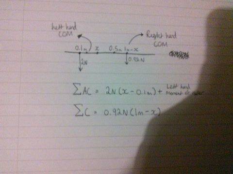

A metre stick has its centre of mass at the 50cm mark, and weighs 0.92N . A 2.00N weight is stuck to the 10cm mark with massless glue. About which point will the ruler balance?
Σclockwise = Σanticlockwise
2 N * 0.4 m = 0.8 Nm
There needs to be a 0.8 Nm moment on the other side.

Let the balance point be 'x' metres from the end of the ruler closest to the 2N weight (draw a picture with dimensions).
Let anticlockwise torques about that point be positive.
For balance we know: ΣT=0
So
0= 2N(x-0.1m) - 0.92N(0.5m-x)
Solve for x

"Here was my attempt. About x,
Total anticlockwise moment: 2N(x - 0.1m) + moment of the ruler to the left of x, how would I find this?
Total clockwise moment: 0.92N(1m - x)"
So you did this a little differently, not finding the anticlockwise moment of the ruler (why not?) and using 0.5m - x instead of 1m - x (but wouldn't that just give you the clockwise moment exerted by a small portion of the ruler right from x?)
Did you draw a picture? It seems like you haven't.
Drawing a free body diagram should be the first step for many physics problems, including this one. Draw one, if your error doesn't become clear post your drawing and we can see where you went wrong.

Did something rudimentary, but here's V2.
What I'm seeing is that I'm considering left hand/right hand COMs whereas you've done away with that altogether and said that the weight of the ruler would act down it's own COM at 0.5m. Are you sure? I've tried to learn from the other moments question I posted to consider two COMs. Wouldn't the weight produce two moments about a given pivot?
Either approach will work but in this case considering the COM of each half unnecessarily complicates the math (and the FBD).
If you do want to consider each half then you need to recognise that each half weighs half the total weight.

I'm not considering each half, but the splits that x make. So x/2 (left hand COM) and 1 - x (right hand COM).
But going by the lone COM:
2(x - 0.1) = 0.92(0.5 - x)
2x - 0.2 = 0.46 - 0.92x
2.92x = 0.66
x = 0.23

I had a look. I'd take the same approach you did in post #6. Be careful with units, at one point you add a force to a moment which is like trying to add litres to kilometres - it doesn't make sense. But you got to the right answer in the end.
FBD?
FBD = free body diagram.
That approach could also work but is even more complicated than considering each half as not only the lever arm length for the self weight depends on x but also the magnitude of the self weight force.
2.92x = 0.66
x = 0.23
That's the answer I got. Good work.
