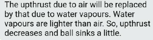

The same question is given in a book with correct option given as a) .
What do you think of this explanation ?

BvU said:
Yes/No. That means he takes ##\rho_{\rm air} = 0 ## which makes the exercise pointless.
Ok . I think this point also needs to be cleared .
@BvU you are saying that if density of air is assumed 0 , then level doesn't change .
I am getting the impression that you believe that if air pressure is assumed uniform , then too, the ball sinks . Is that so ?
Please clarify what option would you choose if we assume uniform air pressure .
  • #39
Accurate (editing: But not accurate... see post 41 at the bottom=this is inaccurate in the logic they used), but really getting overly detailed. What temperature is the water at, so that the vapor pressure of the water can be included as part of the problem? Was there water vapor, and what was its pressure in the initial case? ## \\ ## Then, it could even get more detailed: Does the cork expand when the vacuum is made above the cork? ## \\ ## Also, in regards to the water vapor, do we continually pump the water vapor out, so that its pressure is negligible? ## \\ ## I think we all came up with a pretty good answer considering the question didn't contain all of these minute details.
  • #40
Charles Link said:
Accurate,
Really ?
Upthrust remains same . Upthrust is always equal to the weight of the ball .
  • #41
Jahnavi said:
Really ?
Upthrust is another word for buoyant force. They are claiming water vapor will create a buoyant force after the beaker is evacuated, but that it will be less than than the buoyant force from the air pressure. That same water vapor pressure would have been present in the beaker before it was evacuated. ## \\ ## They got the correct answer, but really are over-thinking the problem as it was intended. It should not be necessary to include water vapor considerations in this problem, and I don't think the people who designed the problem needed to specify that. ## \\ ##Editing: In addition, the water molecule is lighter than ## N_2 ## or ## O_2 ##, (they got that part right), but the water vapor pressure will not be anywhere near 1 atmosphere. Even though they presented this extra detail, they overlooked the biggest reason why the water vapor can be ignored=the vapor pressure of water, (except near boiling temperature), is much less than 1 atmosphere.

  • #43
That a book from a top institute too ? :rolleyes:
I agree with Charles. Fortunately it doesn't work against a) as the correct answer.
