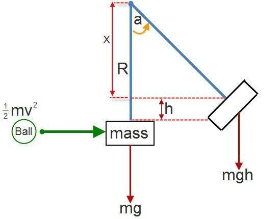

I have been trying to get my head around the concepts of energy, work and momentum. I am trying to build some testing equipment to measure the "transfer of energy" of a moving object striking a pendulum type mass, but am unsure if my physics is correct.
The image attached is my idea for the testing equipment, and below is my working. Now, I am unsure is if I should now take into account rotational physics or the horizontal component.
Length h (maximum height of the mass)
h = R - x
x = R[tex]\times[/tex] cos a therefore,
h = R - ( R [tex]\times[/tex] cos a)
Kinetic Energy of the Ball
1/2 [tex]\times[/tex] mvmv
Potential Energy of Mass
mgh.
There will be energy losses due to heat, sound, vibration and possibility the rebound of the ball, but does;
mgh roughly = 1/2 [tex]\times[/tex] mvmv ?
Am I right in my logic, or do I need to take into account the vertical movement as well?
I wish to place foam pads in front of the mass and look at the height at which the mass is elevated too compared to an impact with no foam pads.
My understanding of the principle of work is that it takes energy to move something in the direction of the force. Even though the force applied is in the vertical, we are still getting horizontal movement.
Can someone share some light on the matter please?
Cheers
K

Looks good.but U will need to calculate the curved trajectory circumference between the two objects to get a distance. Use the distance to calculate acc vel of the object. so you can calculate the terminal velocity on impact , so the moment of impact you will know how fast it is going
To find the curved trajectory R X pi\a= trajectory circumference
It works on the principle of momentum transfer. If the bullet has a mass m and velocity v, and the pendulum mass is M and recoil velocity V, then
m·v = (M+m)·V,
if the bullet lodges in the pendulum, and does not bounce off.

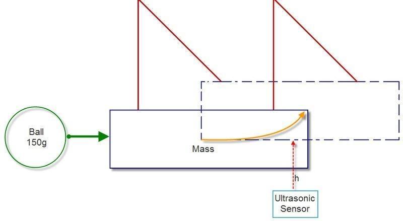

I probably should have stated the know variables which are;
Mass of Ball
Mass of the Mass (LOL)
Average Velocity of Ball
And Height.
Below is an image of a more refined idea. We know that the some of the kinetic energy will be transferred into the mass in the form of kinetic energy rotating the mass where that energy will turn into potential energy at the peak height of rotation, then back into kinetic energy on the way down.
By measuring the maximum height the mass attains, we can then work out the amount of work done by the ball to move the ball to that height.
Now... by using the coefficient of restitution we can calculate the velocity of the ball when rebounding off the mass (as the mass is solid and heavy)
Thus, we can now calculate the initial momentum of the system, and the momentum of the ball after rebound.
The problem however now lies in calculating the equivalent force required to move the mass to that height.
Anyone shed some light on the matter?
Cheers
K

The momentum transfer is just the impulse, or the time integral of the force (mass times deceleration). If the ball falls to the ground after hitting the mass (coefficient of restitution = 0) then
MV=mv
If the ball bounces back with a 100% coefficient of restitution, then MV =~2mv for a large M/m ratio. The kinetic energy of the recoiling mass is ½MV2.
So Mgh = ½MV2 = (MV)2/2M
Bob S
