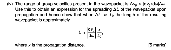

However,I am still confused as to why ##\Delta x = L_{0}## though - how come the change in the position of the wavepacket always equals ##L_{0}## ?? I get that ## v=\frac{L_{0}}{T}##, if ##T## is the period.. but I don't think that's what you mean - could you explain a bit more? (sorry!)
They also then went on to ask a question, (please see attached) about group velocity dispersion. I thought this was easy to solve - we use the result we are supposed to have just found to get:
$$ \Delta v_{g}= \bigg| \frac{dv_{g}}{d\omega}\bigg| \frac{v_{g}}{L_{0}} $$
$$ \Delta L=\Delta v_{g}\Delta t =\bigg| \frac{dv_{g}}{d\omega} \bigg|\frac{x}{L_{0}} $$
if ## L >> L_{0} \implies \Delta L \approx L ##, and result follows.
But now I'm unsure if I cut something out - ?
Thanks!
