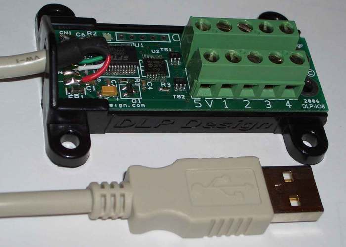

I'm not sure what you will be using to read them but I use this 8 channel data acquisition hub and custom applications that use "lookup tables" to net you the proper readings in pressure.
That's assuming you are interested in using industry standard 0-5v.
http://www.dlpdesign.com/usb/io8.shtml
