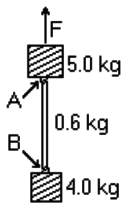

I have here a problem asking me to find the tension force on the lower end of a rod with mass of 0.6 kg. The rod connects two blocks, the first / upper one has a mass of 5.0 kg while other/lower one has a mass of 4.0 kg. There is an upward force of 150 N applied on the whole system.

If my 2nd solution is correct, why should I only consider the mass of the rod and not include the mass of the lower block?

It's very hard to picture this. Can you provide a diagram?
I assume the force is applied to the bottom of the stack? Have you drawn a free body diagram on the lower block and shown the forces acting on it?

Mod note: Copied diagram from Word doc and added it as an attachment.
Here is the diagram of the problem. Thank you for replying.

Assuming, as UchichaClan13 suggests, that gravity is present.
You already determined that the mass of the combined assembly is 9.6 kg. Using the equation w = mg, what is the weight of the combined assembly?
From your free body diagram, there are two external forces acting on the assembly: 150 N and the weight (gravitational force) mg. What is the net force? What is the acceleration?
Next, you are going to have to do a free body diagram on just the lower block so that you can determine the force of the rod acting on this block. From Newton's 3rd law, how would this force compare with the tension force that the lower block applies to the rod?

$$150-9.6g=9.6a\tag{overall force balance}$$
where a is the acceleration of the assembly. So,
$$a=\frac{150}{9.6}-g$$
$$T-4g=4a\tag{force balance on lower mass}$$
where T is the tension exerted by the rod on the lower mass, and the tension exerted by the lower mass on the rod.
So,
$$g+a=\frac{T}{4}=\frac{150}{9.6}$$
So, $$T=62.5 N$$
