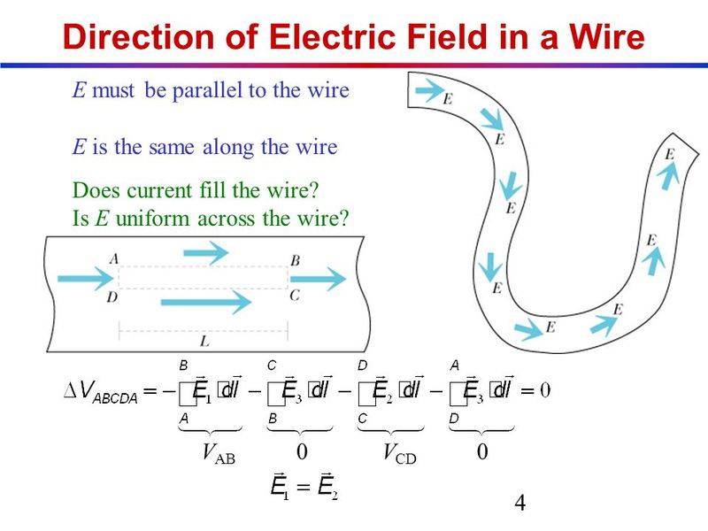

I have a question what does create a electric filed inside coducting wire? And is it the same field trought the whole wire? Thanx for answers.

Well ... it's only the potential which creates the field ...
Imagine the +and - above are terminals of a battery ... once you put a wire across , this channels the "field".

Ok, than the question is how wire chanes the field?
In the beginning there is only the potential difference of the battery and the relevant charge densities at the poles of the battery. After that the charge densities start flow into the good conducting wires (because of the initial Electric Field that exists there when we bring a piece of wire close to one pole of the battery). This flow of charges is essentially a current, and this current travels down to the wires as a wave according to the laws of Maxwell's equations and Ohm's Law (for more on that you might want to read on transmission line theory https://en.wikipedia.org/wiki/Transmission_line) and this current wave has the speed of light. This current flow is essentially responsible for all the surface charge densities that will appear in all parts of the circuit, even those parts that are distant to the poles of the battery. These surface charge densities are responsible for the E-field along the wires.

"And is it the same field throughout the whole wire?"
The current in a wire is I=V/R. The electric field at any point in the wire is E=I\sigma/A, where \sigma is the conductivity, and A is the cross-section area of the wire. If A is constant, E is constant. If A varies, E~1/A.
Ok so what is than the source of electric field in conducting wire? Not the voltage of battery but the electrons in the wire?
The source of the electric field is the voltage in the battery. The magnitude of E at any point in the wire is given by my first answer.
