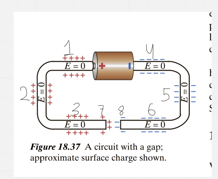

I wanna know the surface charge density in different regions while circuit is open. I don't think the paper contains picture of that and constructing it myself is quite hard

If you agree with my logic, then one interesting question that I have is on the positive side, we should get surface charge distribution in a way that it decreases each time we get more far away from positive terminal. As in region 1 has more density, then region 2 has less, then region 3 even has less than region 2. Otherwise, my logic fails. Note that I am only focusing now on open circuit as in my image. Would it be correct to assume region 2 has less than region 1 and region 3 has even less than region 2 ? If so, figure 7 does not fully explain this as at some points in region 2, there is even more density than in region 1. This is what fig 7 says. Maybe it shows it like this because circuit is closed ? If so, I could understand it as more things going on when its closed so it is a totally different scenario but when it is open, we should not have any place in region 1 where density is less than in region 2 so we should have decreasing density all along. Thoughts ?

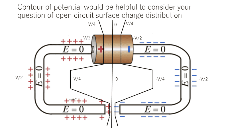

One thing I'm worried about is I wanna know the surface charge density in different regions while circuit is open. I don't think the paper contains picture of that and constructing it myself is quite hard. I want to look at surface charge density distribution while battery is connected to wire, but wire's ends are not connected to each other - hence open circuit and no other components in it at all. Q1: Would you be able to find an image for that ?

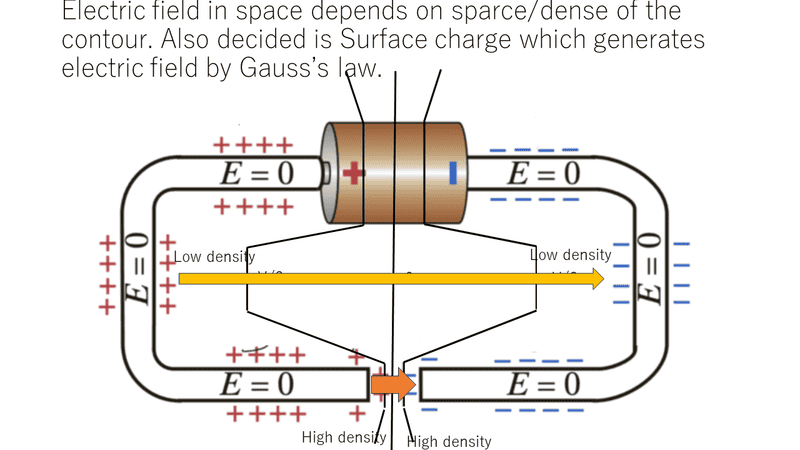

Please find attached the sketches I draw on the picture you quoted. I hope this gives you some insight for your problem.
Annotated diagram of a closed loop circuit around a cylindrical battery with a plus and a minus terminal. Red plus signs line the top, left and bottom wires, blue minus signs line the right wire, and labels read V/4, V/2, 0, -V/4, -V/2 and E = 0 on the wire segments.
Handwritten-style annotated diagram of a battery connected to a closed rectangular conductor loop, with red plus signs and blue minus signs marking surface charges, E = 0 labels inside the conductor, and a yellow arrow showing the field in the wire labelled low density and high density at the connection points.

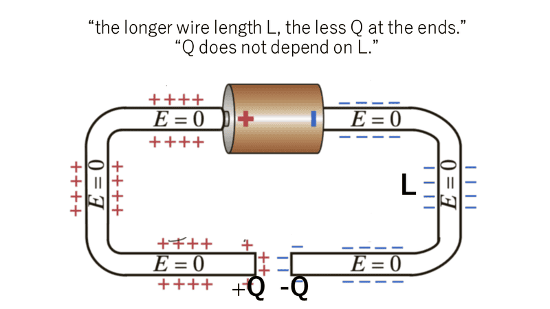

Thanks for your reply. To understand your idea please find attatched your idea and mine on the sketch.
Diagram of a closed rectangular wire loop with a battery in the top section, showing red plus signs and blue minus signs as surface charges on the wire, labelled E = 0 inside the wire, with +Q and -Q marked at a gap near the bottom right, and length L marked on the right side.

ASSUMPTION 1(open circuit): as I said previously, in region 1 and 2, there're different magnitudes of E produced by the battery due to the distance as region 2 is more far than region 1. Due to this, in order not to be constrained to say E=0, in region 1 and 2, we need the opposite magnitude of E so E_net = 0. If we assume surface charges are the same in both regions, we'll be doomed as it can't cancel out both E1 in region 1 and E2 in region 2 as E1 > E2, so in order to cancel out E1, there must be more surface charges in region 1. I think you agreed with me here and I will go ahead now and say that by following this logic, on the positive side(focusing only on positive side for simplicity), we should get surface charge distribution in a way that it decreases each time we get more far away from positive terminal. So region 1 has more surface charge density than region 2 and region 3 even has less surface charge density than region 1. So it's like r1 > r2 > r3. This is only true for sure as long as E produced by the battery in region 3 is less than in region 2. By looking at my open circuit, it might not be true, but you get the point that the more far away the region is from the terminal, the less surface charges will accumulate there than in the region that's closer to the battery. Also, on the very end(Region 7), we will still get surface charges depending on the E by the battery in there which I repeat for sure will be bigger than E in region 3, so region 3 should have less surface charges than region 7. I think this all sums it up roughly. So sum up is more strong E field is by the battery in a region, that region will have more surface charges then other region where E by the battery is lower. This all translates to the distance from the terminals to where we're checking to see surface charges.
The reason I want to get green light about the my assumption above is, on the paper, I looked at fig 7 and i can see that in region 1's some parts, there're less surface charges, then in region 2's some parts. I understand that fig 7 depicts the closed circuit image, but I'm trying not to make a mistake here. hopefully such phenomena wouldn't be produced in open circuit right ? if so, I get the idea and should be enough.
  • Figure 18.37: circuit with a gap, showing approximate surface charges. Battery at top with + terminal left; plus signs on outer and inner wire surfaces, minus signs on the right, E = 0 labels on wire segments, numbered regions 1 to 8 handwritten.
