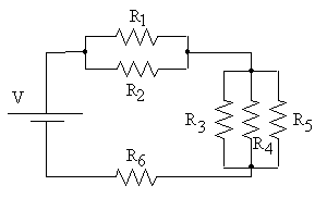

Consider the behavior of the circuit, when various values increase or decrease.
(Select I-increases, D-decreases, If the first is I and the rest D, enter IDDDDD).
A) If R3 decreases, the current through R4 ___.
B) If R3 decreases, the current from the battery ___.
C) If R1 decreases, the current through R3 ___.
D) If the voltage V decreases, the total current from the battery ___.
E) If R1 decreases, the current through R6 ___.
F) If R6 decreases, the power output from the battery ___.
P = VI
V = IR
A) I = V/(R3+R4+R5) so if R3 decreases, the current through R4 increases
B) If the current through R4 increases, the current through the battery decreases (conserved)
C) increases (because current from R1 increases)
D) V = IR, so if V decreases, I decreases
E) increases (same as C)
F) If R6 decreases, current increases, so power increases.
So, IDIDII. But this is wrong, and I'm not sure which one I'm not understanding correctly. The diagram is attached!
  • Circuit schematic with a battery labelled V on the left, resistors R1 and R2 in parallel at the top, R3, R4 and R5 in a combined parallel network on the right, and R6 in series along the bottom wire.
I don't know if this is correct. If you were to combine R3, R4 and R5 into one equivalent resistor, lowering R3 would lower the equivalent resistance, thus increasing current from the battery, so I think your part B is wrong. Although I could be wrong.
I understand what you are saying, but I tried IIIDII, and it's still wrong, so I think I'm still missing something...
Perhaps: If R3 decreases, more current would flow through R3, hence the current through R4 would decrease.
