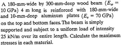

Is this correct?
The discussion focuses on the bending of a simply supported beam, addressing the calculation of bending stress, specifically sigma_w. The participant points out an error in the placement of sigma_w, indicating that it is measured at the incorrect fiber distance. This highlights the importance of accurately determining the location of stress calculations in beam analysis to ensure correct results.
