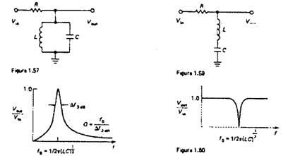

I was wondering if there is a way to desing a perfect coil for this application, since the sample will be a disc of liquid substance. Of course, the coil circuitery must be complete with all the capacitors needed to implement a resonance circuit (Tuning and Matching) at a given frequency (i.e. 600 MHz):
Obviously the RF coild must generate and read an electromagnetic field othogonal with respect the main field generated by the superconducting magnet.

1c) The resonant circuit will must mainly match the resonant frequency at that field, the Q-factor is not decisive since the measure will consists into a simple echo or cmpg-loop for T2 measures and the sample molarity can be arbitrarily high.
