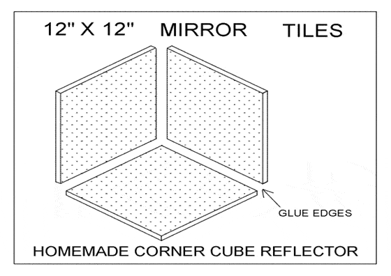

I have been given the task of building some large RF reflectors that will reflect 35GHz RF energy.
Can anyone give me an idea of what material / thickness of material I could use.
For an example.. Would a pyramid made from wooden pallets covered in tin foil do the job?
Thanks in advance..

Aluminium foil in simple flat sheets does work but sometimes not very well
Traditional solution is a tethered array of Aluminium beer kegs .
Arrays of bin bags or big plastic tubs stuffed with loose foil strips work surprisingly well .
3D objects usually give better targets than flat surfaces where incident signal can come from any direction and especially for airborne radar detection .
See Skolnik - Introduction to Radar Systems . Mc.Graw - Hill
Makes sense. A flat panel of aluminum foil would probably act like a mirror and just reflect the incoming signal away from the source unless it was aligned almost perfectly towards the source.
PhysicBob said:
Unfortunately no I can't say. It's an aircraft mounted radar that's about all I can say. The reflectors will be on the surface of the sea. Does that help?
Use metallic cube corners that are several wavelengths in size. Cube corners are retro-reflective, so incident RF energy will be reflected back the way it came. You can have several cube corners facing in different directions, so no matter the orientation of the target, you will get a good radar reflection back to the source.
http://www.discovercircuits.com/DAJ-Schematics/corner.gif
