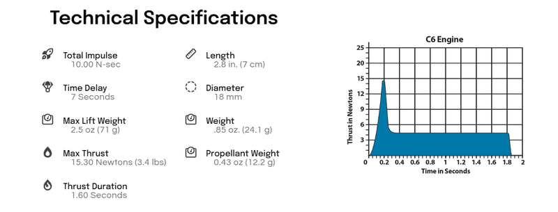

boneh3ad said:
The hard part of that is knowing what the thrust profile of model rocket engines is,
The manufacturer has a sheet.
Reply
Thank you for all of the suggestions I will be talking with my team and looking through the thrust profiles of different rockets.
Reply
Sure, but how repeatable is it? And at what level of detail?
It looks like they do get fairly detailed in the specs.
Reply
Yeah, that's pretty nice. I wonder if they would give you the actual data so you could use it in a numerical model. If so, you could get a pretty decently accurate estimate of altitude based on a pretty simple ##\sum F = ma## model that incorporates thrust and drag in real time. Just tweak the overall mass until you get the height you want. The issue would be repeatability of the motor, i.e., what's the uncertainty band on those curves?
