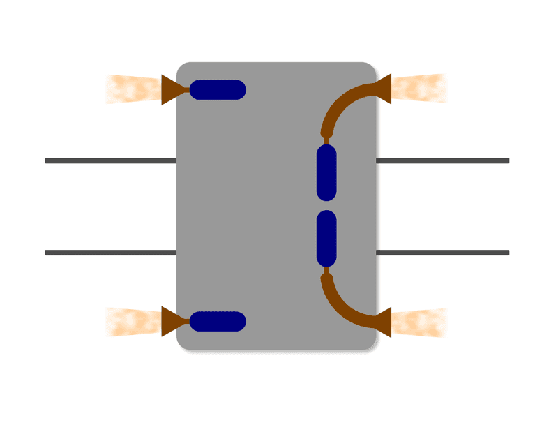

Hi,
*Excuse the crude visualization and possibly imprecise description - I'm not a rocket scientist :)
So, I have a friend that has come up with a "new" concept for a rocket propulsion design, and although I have a hunch that it might not work better than existing designs I cannot really explain it properly or find the issue with his design, so here it is ...
Instead of having 2 rockets firing outwards into space (left side), we will have 2 identical rockets firing into a curved chamber that will then in turn dispose of the gasses outwards (right side). His design is basically what you see on the right side part of the diagram.
I came up with this simplification of how we could test it. (The fuel tanks are in blue). There would be a platform, mounted on 2 rails, in a way that it could only move forward/backward, and when we start the burn on both sides of this "system" which way would be platform move ?
According to him because of the better design and how mass hits the curved walls the platform would move left, but to me it seems the exhaust would be hindered on the right side so thrust would be lowered and the platform would move to the right ?
It would be interesting to see what everyone's thoughts are on this, and if there's any type of calculations that can be performed instead of just saying that it would move this or that way ...

Welcome to PF.
It seems like there would be more friction/heating losses in the longer curved ducting sections for the right side design, so it would generate less thrust. Where exactly are the combustion chambers in his design?
You didn't say in what way the new design is expected to be better than a conventional rocket. And if better, why?

The combustion chambers would be just next to the fuel tanks in both cases, and yes there would be for certain heating loss in the curved ducting, as well as more friction, but there would also be additional forces from the exhaust gasses acting on the curved wall adding to the thrust, however since the speed of the ejected gasses would most certainly be slower how would that translate to total thrust,- one gained by forces acting on the curved ducting minus the losses that occur while doing so,... I wonder.

All that matters is the momentum of the ejected material. If it's slower, that's bad.
Those "additional forces" already happen in the expansion bell of a normal rocket engine. This will add extra losses and would substantially reduce efficiency (and make it very difficult to cool - the heating rate along the outside of that curve would be extremely high).

In practice your friend's design is deliberately avoided, and is referred to as 'line losses'. The pressure loss (or energy loss, if you will) is greater than zero and only amounts to a loss in energy that your engine can expel in the form of thrust. I see what your buddy is getting at, trying to "employ" this sort of line loss to work as an advantage, but the bottom line is that this would simply increase these line losses.
There's a reason that SpaceX's Raptor 2 was a search to simplify design and reduce complexity. At the end of the day, all we want to do with our combusted flow is push it out, in a single direction, as fast as humanly possible. I'd venture to say that the platform you've drawn, in theory, would move right due to increased line losses on the "curved design" engines.
I'll spare you the technical details on how a throat functions to contain a normal shock as well, but trust me, if the flow leaving that blue tank is indeed encountering a normal shock, then the curved design would be a nightmare to cool and would likely encounter a thermal choke, which would just melt your engine.

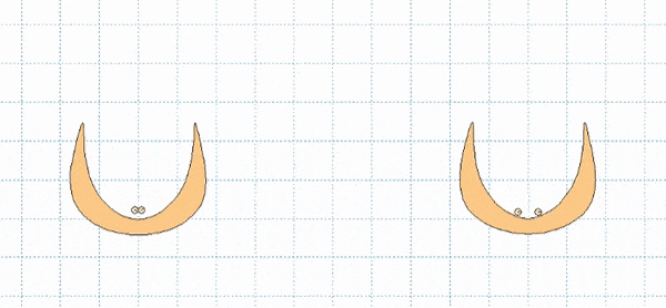

Thank you all for the comments and suggestions!
First of all I was thinking that by testing this with CO2 with air around it wouldn't simulate a rocket properly because quite a bit of force would be generated by CO2 pushing against the air, forming a sort of pressure bubble, but considering the right hand side has reduced pressure, the left part would still be more efficient.
I don't know how much force is generated in a rocket from forces other than the fuel being ejected (for example the gasses hitting the flair) but I am assuming it's not very much ...
I've just done a quick simulation of mass bouncing at 90 degrees vs. following the curve path and of course the 90 degree path is more efficient, I realize this is a simplification.
Can you post your code that generates this simulation?
It's an old program I have called Interactive Physics, and I was using a mass of 19 kg for the U-shape, and for the "fuel" there's a mass of 0.5 kg for each of the balls, and they are traveling at 10 m/s. On the left side they are traveling downward, and the right hand side of the simulation they are traveling at 180 degree away from each other.
The software is so old it only generates .avi files which in turn I converted to .gif :)
I have also made a similar simulation in Algodoo.

escape75 said:
I figured we could now see what happens when the payload is thrown at 90 degree on a curved track, versus in the opposite direction of the object being propelled.
How does that differ from a fluid in a pipe going around a 90 degree elbow?
I believe it would be no different, I think even a simulation using fluids would show the results.
Is there a good fluid simulating software available that could be used ...

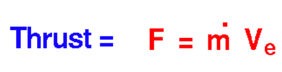

Actually, here, you've inadvertently displayed the function of a nozzle. Your diagram on the left displays gas particles that are optimally expanded, so they flow directly normal to the bell inlet. Your diagram on the right is akin to the combustion chamber, or extremely under-expanded flow, as the gas particles attempt to expand outward.But anywho, this model is incorrect. The thrust equation shown below displays that the force exerted by the rocket is equal to the mass flow of the propellant, multiplied by the exit velocity of the propellant. For your model above, both the exit velocity and mass flow are equal, thus the object should be moving at equal velocity in both models as the object incurs equal force in both models.
(Yes, I am aware the pressure correction portion of this equation has been omitted)
The equation above could also be restated as Thrust = the change in momentum of the gases leaving the engine. Since the mass of the flow isn't different or changing between models A and B, nor is the exit velocity different between models A and B, the two systems are generating equal thrust.So AGAIN, to the original question: To maximize the force generated by an engine, you need to maximize the exit velocity! Therefore, since the thought-experiment design has losses in flow energy due to the line losses I had previously mentioned, it will generate less force.
This is admittedly getting a bit more advanced than the original question, but at least in atmosphere, this is not correct. To maximize the force generated by an engine, you want the pressure at the exit plane of the nozzle to match the surrounding ambient pressure. You could achieve a higher exit velocity if you expanded the nozzle further, but this will cause the exit pressure to fall below ambient which causes the pressure thrust term to become negative, and the negative pressure thrust grows faster than the increase in momentum thrust from the slightly higher exhaust velocity. This condition would be known as an optimally expanded nozzle.
In space, of course, this just means to expand it as much as possible (until the extra mass of the longer nozzle outweighs the performance gains from the extra thrust), since the pressure at the exit plane can never fall below ambient.
This simulation only shows how a nozzle works, not the curved design you posted in the first post.
Perhaps set up a simulation where a particle is ejected directly into a straight 'pipe' and then out into space compared to one that is ejected into a 'pipe' that bends 90 degrees before opening into space?
I'm not sure the software can simulate this properly, after all the only interaction this simulation shows
is how the 2 masses interact with each other when they're either sent directly out (by 1st making contact
with each other - left side) or out on a curved path (right side).
