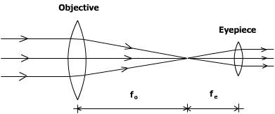

I think you may be right above. But I think some of us get wrong somewhere before.
It's like this. a 7x35 binocular.. there is 49X of light focus into a point (compare to our pupil). But it's subtending 7 times the angle on the retina. So...the light density is reduced by 49x!
So we are not really looking at 49X of the light intensity at the focal point.. it's reduced because its subtending 7 times!
Therefore when looking at a compact fluorescent lamp 20 meters away. You won't have more intensity of the blue light harming your eyes. It's same intensity as original. Is it correct.. or not.

So when we look at leafs thru a telescope, and the objective is say getting 49 more light to a point. how big is that point?
The light from any point on the leaf will be spread out into an airy disk, the size of which depends on the optical properties of the whole system, including the eye.
cube137 said:
is the 49 X diluted by 49 X back to same brightness or is there a point at focal plane that is really 49 X bright?
For an extended object, yes, the image through the telescope or binoculars is the same brightness as it is through the naked eye. For a point-like source, like a far away star, the brightness is generally increased since even after you magnify the image the object is still unable to be resolved as anything but point-like. (Just like Merlin explained in post #23)

Not necessarily. If the lamp is small enough, then magnifying its image won't spread the light out very much, so the intensity increases drastically, similar to how a point-like source acts.
Honestly if you're worried about blue light harming your eye, just buy a blue-blocking filter.

Now going to the 49X of light converging into a point. Let's take the case of one airy disc. Does it mean the 49X of light intensity are spread into the diameter of one airy disc and diluted 49X?
The basic idea to take away is that for an extended object the brightness of the object decreases with magnification. In this specific example, the increase in light-gathering ability of the binoculars over the eye is directly countered by the reduction in brightness by the increased magnification.

The sunlight isn't spread to a larger area, it's spread to a smaller area. A magnifying glass is not a compound optical system and doesn't behave exactly like we've discussed here.

You have justified the points I made in my last post. A point source becomes an airy disc: already discussed at length. Magnification will not alter the energy falling on the image: already discussed.
The angle subtended by the Sun is about 0.5°. Is that a "point"? The Moon is about the same apparent size and we can see many features with the naked eye. That is definitely not a point. : We already discussed the idea of replacing a distribute source by a set of points so that would apply to the Sun, also.

I wish I had time to find some good pictures and to go into detail on this subject, but I'm doing homework and studying for a physics exam tomorrow. :sorry:
