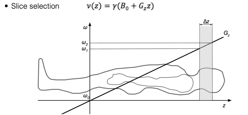

1. We can apply an gradient in the z-direction to make the Lamor frequency a function of z. This allows us to select a certain slice by applying any range of frequencies for our RF pulse.

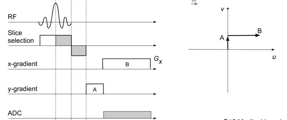

2. Now that we have a slice/slab, we want to get information more specifically from different points in the x-y plane. Therefore we apply a readout gradient. My main misunderstanding is how this helps us.
Question 1: How does the readout gradient help us traverse x-y space? It looks like the gradient pulses move us in the ## u ## and ## v ## directions in ##k##-space (which I understand to basically be Fourier space). From animations of this process, it seems like the readout gradients move us in ##k##-space, rather than us moving around manually.
My guess of how this works is that:
- when we apply this gradient coil, this introduces a spatial variation for the Lamor frequency in that same direction (e.g. x-gradient pulse introduces spatial variation in x-direction)

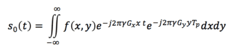

- This then causes an integral (based on the above diagram) for the signal to be (I believe ##T_p## is the time of the y-gradient pulse):
Question 2: Why can we just substitute the ## G_x x ## for ## u ## and likewise for ## v ##? I understand that the pulses introduce a variation in the respective directions, but am not sure why that means we can make the substitution.

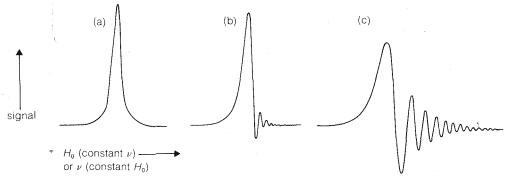

https://chem.libretexts.org/Bookshelves/Organic_Chemistry/Book%3A_Basic_Principles_of_Organic_Chemistry_%28Roberts_and_Caserio%29/09%3A_Separation_Purification__Identification_of_Organic_Compounds/9.11%3A_Nuclear_Magnetic_Resonance_Spectroscopy said:
Figure 9-25: Comparison of sweep rates on nmr absorption curves; (a) 500-sec sweep, (b) 50-sec sweep, (c) 10-sec sweep, The "ringing" in the faster sweep curves is a transient effect that has a small effect on the position of the peak and none on the integral.
Image compliments of http://hyperphysics.phy-astr.gsu.edu/

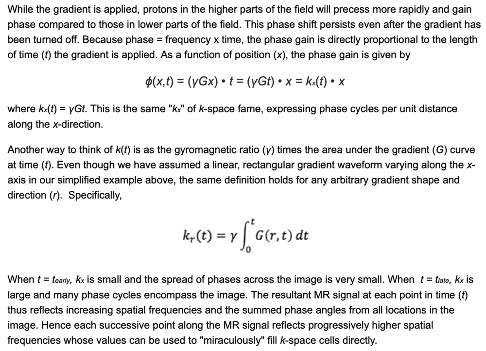

The one part I cannot understand is on this page here: https://www.mriquestions.com/why-signal-harr-k-space.html and I have put a picture right below of the specific section:
and the text some time below states (only referring to the last paragraph in the image, but have included the rest for context):
Why is it the case that the resultant MR signal at each point in time (t) thus reflects increasing spatial frequencies and the summed phase angles from all locations in the image?
Why would the frequency vary with time if the pulse amplitude is constant (as often shown in these examples)?
- From reading, when the readout gradient is applied, it introduces a variation into the natural resonant Lamor frequency, but I cannot see how that varies with time while the pulse is activeIf I accept that as true, then the next step of the logic seems reasonable. Each point in time on the signal represents a different frequency and phase and thus corresponds to a different point in k-space, which helps us to fill out a row and/or column.
