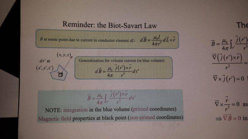

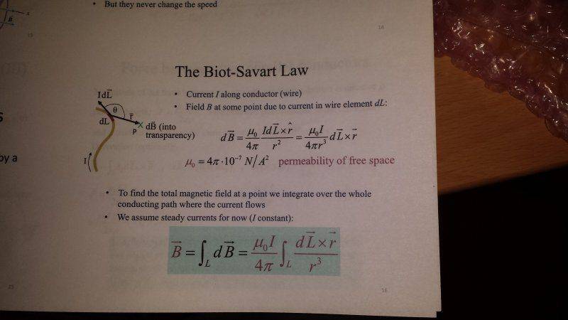

These are all my lecture notes on the Biot-Savart Law.
Lecture slide titled The Biot-Savart Law showing a wire element dL with current I, the field dB at point P, the formula dB = (mu0/4pi) I dL x r-hat / r^2, mu0 = 4pi x 10^-7 N/A^2, and the integral B = (mu0 I / 4pi) times the integral over L of dL x r / r^3.
Lecture slide titled Reminder: the Biot-Savart Law, showing the law for a current element dL and the generalisation for a volume current, dB = (mu0/4pi) j(r') x r / r^3 dtau', with an integral form and a note on primed and non-primed coordinates.
That's literally all I have to go on, my lecturer barely went over it at all. I have some textbooks as well, but they just provide me with what I wrote earlier, which you said was wrong?

I don't see any j=v there.
