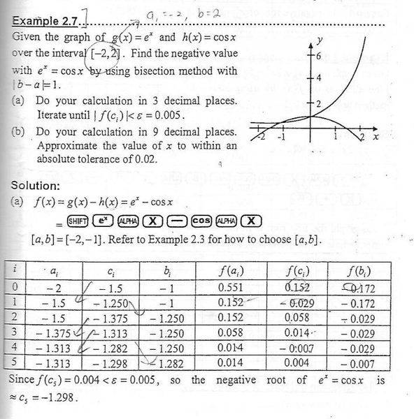

In the first photo , interval [-2 ,2 ] means a = -2 , b = 2 , am i right ?
So , how to show that b-a = 1 ?
IMO , b-a = 2+ 2 = 4

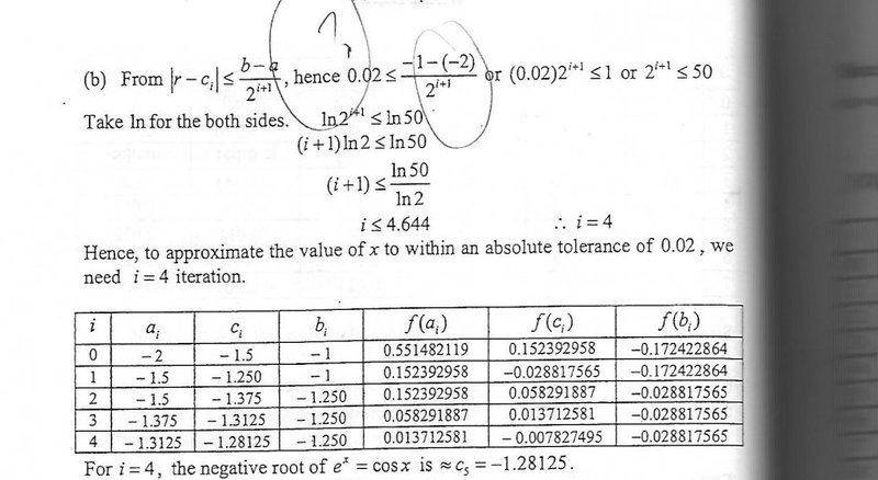

for part b , why b - a = -1-(-2) ?
Is there anything wrong with this question ?
Not so: b and a play different roles.
Refer to example 2.3 for how to choose ##[a,b]##
##[-2,2]## is the interval for which the functions are considered.
The exercise suggests to apply the bisection method on another interval, namely ##[-2,-1]## because you don't need to consider the entire range. For the second question ##|b-a|=|-1-(-2)|=|1|=1##.
