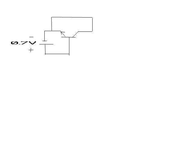

I have a doubt regarding BJT. what happens if both emitter-base & base-collector junctions are forward biased with 0.7V ? will BJT be in saturation region? What will be the voltage across the collector and emitter and Ic ?
-Devanand T
Do you mean you actually shorted out the E and C and drive the B? If that is the case, you just have a diode! If you are talking about grounding the E and drive the B hard, you'll never get the 0.7V across the BC junction.

I am talking about a situation as below :
That's what I thought, you have two separate diode in parallel like I posted! The BJT is two N region separate by the P( base). So they are different diode all together. In IC, the collector is the lightly doped tub. P base is implanted in the middle of the tub with much higher concentration of P impurity. Then the middle of the base is again doped heavily by N impurity to form the emitter. It is literally like two diodes in parallel. And is just a diode in forward bias!
My colleagues were telling no current will flow. But a forward biased diode must conduct current isn't it ?
You bet current will flow in your drawing. Just take a transistor and try it. You put 0.7V, that will turn on the transistor. But it is not safe to connect like it your drawing as you might pump too much current through, you should use a resistor in series to limit the current.
Thanks for your reply. I will try that.
