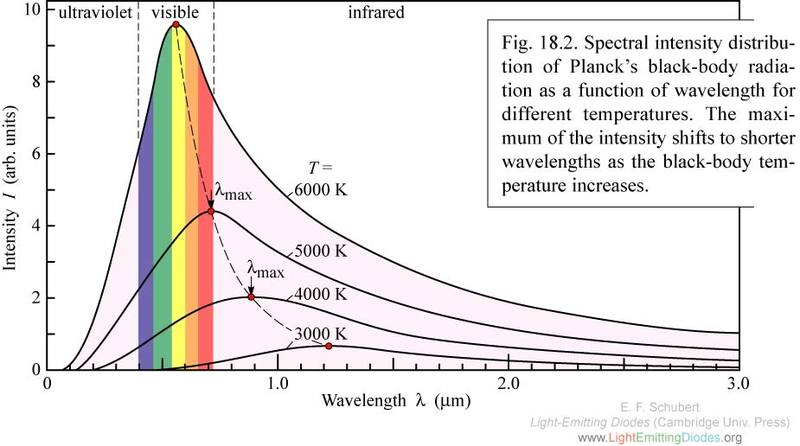

As you heat a body, the energy it emits in any particular wavelength band strictly increases, so even though you are proportionally increasing the amount emitted in UV or x-ray, you are still increasing the amount in the visual spectrum.
As demonstrated here:-
