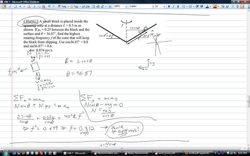

See attempt at solution. I have attached everything there.
F_net = m * a_n (net force)
W = mg (weight)
a_n = 4*pi^2 * R * f^2 ... formula for "normal" component of acceleration where R = radius, f = rotating frequency
Some questions I have about this problem (look at my work below first or these might not make any sense) --
1. Why is there only a vertical component for the weight? I thought weight always has 2 components whenever an object is on an "incline" which it appears to be here. Does this have something to do with the motion being circular?
2. Why does the normal force have two components if the weight does not? (Ncos(theta) and Nsin(theta))? And further, when exactly do you calculate the normal force or weight using components and when do you not? For example I know on all the incline plane problems I've done, the weight always has two components but normal force is just calculated as N - not using NSin(theta) or NCos(theta).
Basically, in my attempt below, I was just following the method my professor used to solve a similar problem (only difference was his problem had a sphere instead of a block and there was no friction) and I don't really understand why he calculated two above quantities the way he did. I did not get the correct answer so I'm trying to figure this out and having a hard time.
So here's my work:
  • Handwritten solution to a block-on-spinning-cone problem: free-body diagram of the block with normal force N, friction f_s = 0.25N and weight mg, plus force-balance equations and the final answer f = 0.812 rev/s.
Friction acts down the slope - this is where you messed up. That means
N sin(theta) + (mu)*N*cos(theta) = m*a
along the radius of the circular path.
Regarding weight's components . Components always along different directions regardless whether the body's on flat ground or a slope. Here your analysis is along the direction of gravity and normal to it - so there is no m*g in one eqn. and complete m*g in other. By the same token normal force has two components as it has some magnitude along both axes we analyse. Remember components are made for our convenience - it isn't that they actually exist uniquely. If I had chosen to analyse along different axes - say one down the plane and other perpendicular to it (which in fact I had) I would have had components of weight and not of the normal force.

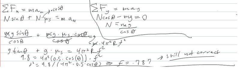

Here is a picture of the updated work:
  • Handwritten derivation on lined paper: sum of F_n = m a_N with N sin θ + N μs = m a_N; sum of F_y = m a_y with N cos θ - mg = 0, N = mg/cos θ; then mg sin θ/cos θ + mg μs cos θ/cos θ = m·4π²Rf², 9 tan θ + g μs = 4π²Rf²; 9.8 = 4π²(0.5 cos θ) f²; f² = 9.8/(4π²·0.5 cos θ), f = .787, marked 'still not correct'.
You should also have a component of the friction in the y-plane.
