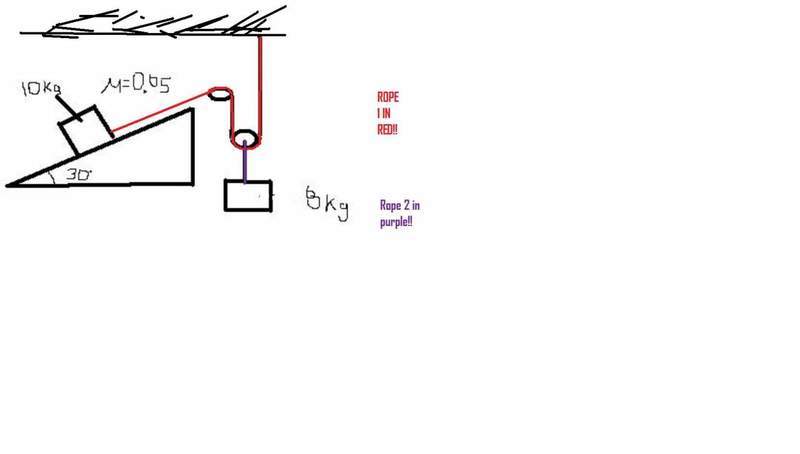

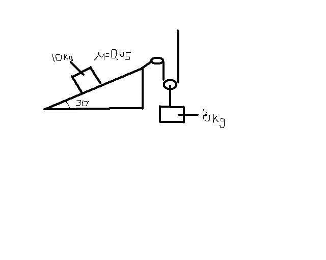

a)which way does this system go?
b)write force equations
c)find acceleration of the 10kg mass
THE ROPE IS SUPPOSED TO BE ATTACHED TO THE MASS NOT THE RAMP IN THE PICTURE
m1 is the 10kg mass..m2 is the 8kg mass
u = coefficient of friction
The system goes to the right because:
Tension>m1gsin-um1gcos
Tension = m2g-ma
Tension-m1gsin-um1gcos = ma
sub in for tension to get
m2g-m2a-m1gsin-umgcos = m1a
78.4 - 8a - 10(9.8)(sin30)-(.05)(10)(9.8)cos30 = 10a
solving for a gives me 1.397
the REAL answer is supposed to be .464
what did i do wrong?♦

I will assume that you meant to show the cord attached to the mass m1, not to the ramp.
vs55 said:
Tension = m2g-ma
Two problems:
(1) The rope (and thus the tension) pulls twice on m2.
(2) The accelerations of m1 and m2 are not the same. (Figure out how are they related.)

yes sorry the rope is supposed to be attatched to the mass not ramp
so is T1 at the ramp = 2T1 at the hanging mass?
Welcome to PF!
Hi vs55! Welcome to PF! :smile:
Doc Al :smile: is offline, so I'll jump in and say …
no, the tension is the same all the way along the same rope.
Use good ol' Netwon's second law twice, once on the 8kg mass, and once on the 10 kg mass, with the same T.

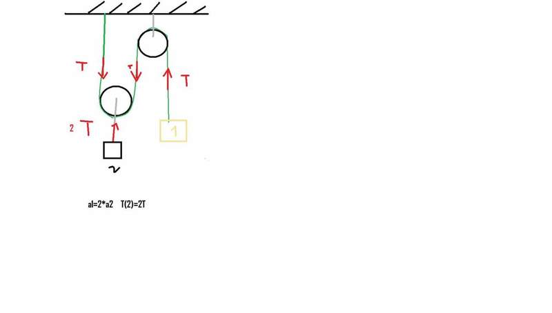

First,I'm not the original poster, I'm just trying to help as You do.
I'm attaching a sketch of the problem , highlighted rope 1 and rope 2, this is system is hard to build with only 1 rope...
what do You think?
what do You think?
It looks like one rope to me, with each end dyed a different color! :-p Of course you can make "one rope" by tying two different ropes together--but as far as the physics is concerned, that's the same as "one rope". It will have a single tension throughout (given the usual approximations used in these problems).

Hi Dweirdo! :smile:
Your new diagram does only show one rope … it goes from you (that is you, isn't it? :wink:) over the top pulley, under the bottom pulley, and back up to where it is attached to the centre of the top pulley.
In the original diagram, the only rope attached to the centre of a pulley is is the one with the 8 kg mass on the end.

I just realized that you are talking about a second rope! :smile: You meant the rope that attaches m2 to its pulley. Sorry about that! (I guess I didn't look at your diagram too carefully... I didn't see any purple and assumed it was my eyes going. I didn't think of looking at that small piece of rope, since I routinely ignore it. :redface:) Of course, that might not even be a rope--it could be a metal rod, a bracket, or whatever.
I generally ignore such things and treat the mass and its pulley as a single object. Saves time! If you include that second tension, you need a third equation relating it to the other tension: T2 = 2T1. But yes, you are correct: the tension in that second rope does equal twice the tension in the other rope.
Of course, tiny-tim and I were talking about the rope that connects from ceiling to m1. It pulls up twice on the m2/pulley subsystem (which I just lump together).

Look , I'll try to settle it down for You.
You can look as if there were 2 ropes or 1 rope, it doesn't matter the thing that matters for you is that the tension pulling the pulley which is attached with m2, is 2T, when T is the tension in the rope...cause you can see that the pulley is covered by the rope thus is being pulled as if from both sides.
look at a picture i attached in page 1, that should help.
anyway:
2T1 + T2 - m2g=0?
is wrong, if You look at the problem as if another rope is pulling m2, You'd say T2-m2=0(if it's not moving) while T2=2T1 is that clear?
the equation of motions:
2T-m2g=m2*(a2)
XXXXXXX=m1*(a1)
the XXXXX means You should try alone... and You should get the relation of the accelerations (hint: while m1 goes Distance X, mass m2 raises height of X/2)
Good luck!
