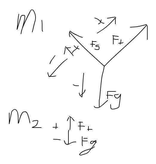

A block of mass m1 = 3.70 kg on a frictionless inclined plane of angle 30.0° is connected by a cord over a massless, frictionless pulley to a second block of mass m2= 2.30 kg hanging vertically. What are (a) the magnitude of the acceleration of each block and (b) the direction of the acceleration of m2? (c) What is the tension in the cord?
Diagram of a frictionless incline at 30.0 degrees with block m1 on the slope, connected by a cord over a pulley at the top to block m2 hanging vertically on the right.
F=ma
Handwritten free-body diagram: m1 with arrows for F_T (tension, up the incline), F_g (gravity, down), a normal force label, and a downward component marked with a minus sign; below, m2 with F_T pointing up and F_g pointing down.
I set the coordinate system according to the diagram above.
System: m1
Ft+Fg=m1a
Ft-m1gsinθ=m1a
System: m2
Ft+Fg=m2a
Ft-m2g=m2a
Ft=m2g+m2a
Then I plug in both of them.
m2g+m2a+m1gsinθ=m1a
m2a-m1a=-m1gsinθ-m2g
Then I sub in the values
a=3.15?
I don't know what I did wrong. The correct answer is 0.735.

You've mad a mistake with the signs. Consider the cord as your coordinate and define its positive direction from m1 to m2. Now redo your force balances with all forces in each direction with the same sign.

Sorry, maybe I didn't express myself clearly. Of course you have to distinguish the direction of the forces by using the correct signs. After defining the positive direction, you know all forces pointing in this direction have positive signs and the rest has negative signs.

It's up to you, but as already proposed in my previous post: m1 → m2: positive

If your coordinate s along the chord is positive from m1 → m2, then for
m1: sgn(Ft) = + 1 & sgn(Fg) = - 1 ... according to the x-axis you defined
m2: sgn(Ft) = - 1 & sgn(Fg) = + 1 ... as s is positive along the chord in direction m1 → m2

Sorry, whiteboard doesn't work on my computer. To see it just draw an arrow parallel to the chord direction pointing from m1 to the pulley and a second one after the pulley pointing in direction of m2. These are the positive directions of your cordinate s. Now compare the direction of each force at m1 with the first arrow: If the force points in the same direction the sign is +. Same for m2 and the second arrow.

In your equation for m1, you have effectively defined the acceleration a as positive up the slope. That means it must be positive downwards for m2, but you wrote your m2 equation as though it is still positive up.
