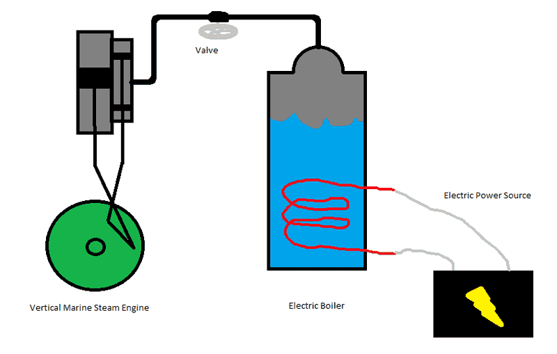

So... I am looking to basically convert electric energy to thermal, then mechanical energy. I am wondering how practical it would be to use a rechargeable car battery (12V, and 40Ah) to boil water into steam for a steam engine. It does not matter how long it would take, simply if it is possible/significant enough to power a steam engine (not a turbine).
Thanks,
-PenguinCo.
Here is an extremely crude (to say the least) MS Paint drawing of how all the parts are to connect.
The big question is "why?"
Converting electrical energy directly to mechanical can be done very cheaply with up to 99% efficiency.
I would expect a steam engine on the scale you're talking would be about 5% efficient.
Small desktop type steam engines usually burn lamp fuel or sim. why do you want to go electric?
With a 480 Whr battery (12V * 40Ahr), you could produce about 480 Watts of heat for an hour or 960 Watts for half an hour, or 1920 Watts for 15 mins etc etc.

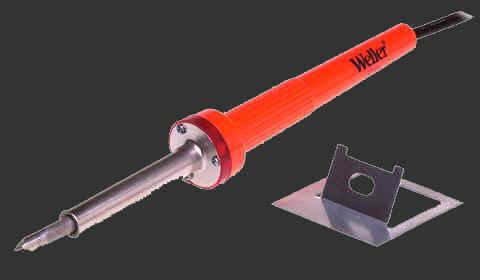

I use a 40 watt soldering iron. The tip is immersible in water and quite capable of boiling the water. It is also intrinsically safe in that if the water boils away, the tip will not melt or destroy itself.
A simple 60 watt inverter like the one below can drive the soldering iron from a car battery.
Well, my definition of practical would look something like so:
A very small boat capable of using a paddle wheel/prop to go at maybe 3-5 km/h.
The only thing I want to replace is bringing solid fuels, so I'm wondering how practical it would be to use a battery instead.

Thank you all for your help, this gives me a good idea of the practicality of my project. The reason I'm doing electric > thermal > mechanical, instead of electric > mechanical, is because I want to build a steam engine. Simply put.
