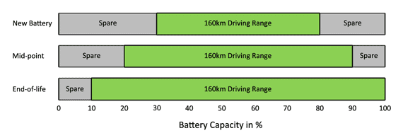

"EV makers must further account for capacity fade in a clever and non-alarming way to the motorist. This is solved by over sizing the battery and only showing the driving range. A new battery is typically charged to 80 percent and discharged to 30 percent. As the battery fades, the bandwidth may expand to keep the same driving range. Once the full capacity range is needed, the entire cycle is applied. This will cause stress to the aging battery and shorten the driving ranges visibly."

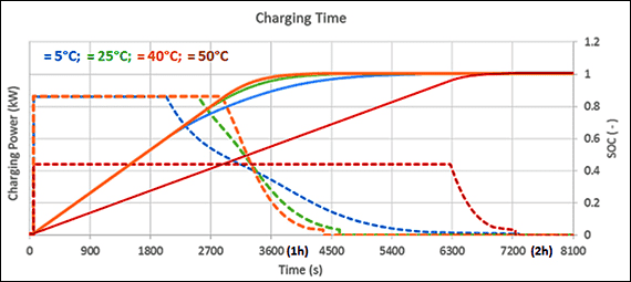

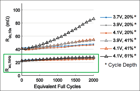

But if you mean to ask about the battery only, and not the battery plus charger combination, this figure from battery university should help.
Power loss during charging is ##I^2R##. If we hold ##I## constant (which most chargers do not do) and hold temperature constant, then increasing R by the ratio 90/38 will increase losses by about 2.6. If the new battery was 99% efficient, then there was 1% losses. When the battery is old, the losses would increase to 2.6% making the charging 97.4% efficient. Is that what you are looking for?
But battery temperature is often more important than R, as the curve below shows. That is why they make the chargers smart. A smart charger that senses temperature automatically adjusts for the changed characteristics of the battery when it gets old and adjusts for ambient temperature. In that case, you can't answer the question about mains charging efficiency without detailed knowledge of power losses inside the charger.
