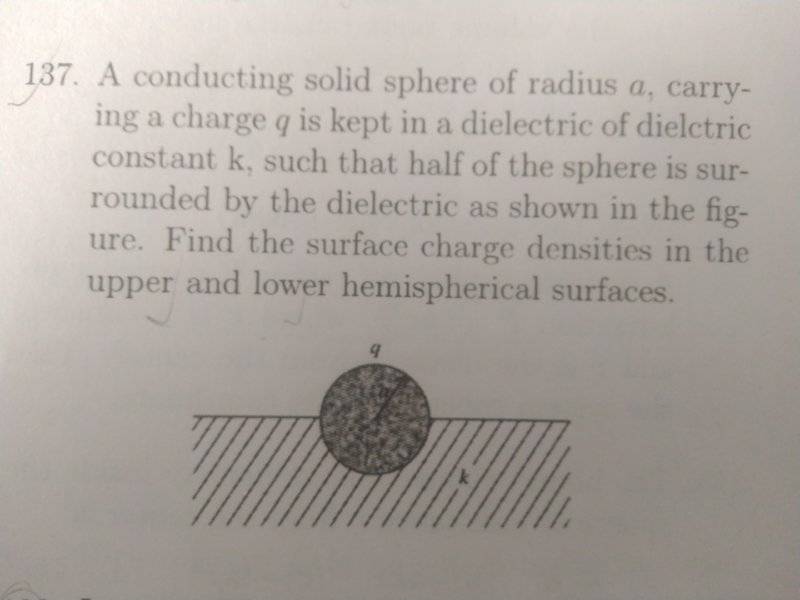

How does the dielectric affect the charge distribution on a charged sphere?
The discussion focuses on the impact of dielectric materials on charge distribution in a charged sphere. The key equations referenced include the integral form of Gauss's law, specifically ∫D_perpendicular ds = q_enclosed, and the relationship D = ε0E + P, where D represents electric displacement, ε0 is the permittivity of free space, E is the electric field, and P is the polarization density. The participants explore how to calculate the electric displacement D2 within the dielectric, emphasizing the need to understand the dielectric's influence on charge distribution.

∫Dperpendiculards=qenclosed freecharge
D=ε0E+P
D1+D2=q/2πr2
at a distance r from the centre
How to find D2 which is at the lower boundary e.g inside the dielectric??

Think about how, if any, would the dielectric change how the charge is on the sphere.
