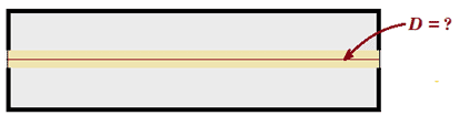

Consider a block of surface ##25cm^2## and thickness 12mm made of lucid a dielectric with ##\epsilon_r = 3.2##. We charge the center of this block with a beam of electron 0.1##\mu A## for 1 second to have a uniform charged layer of 2mm of thickness where the center is at 6mm of the surface of the block.
##\sigma p = \vec{P} \cdot \hat{n}##
##\vec{P} = \epsilon_0 \chi_e \vec{E} = \frac{\chi_e \vec{D}}{\epsilon_r}##
From what I think, to find the bound charges of a block on the top and bottom surface I have to find the electric field or the displacement (D).
However, I'm not sure how to proceed with a cube. For example, with a sphere ##E = \frac{Q}{4\pi \epsilon_0 r^2}## since r is constant.
For a cube, it depends where I'm at the surface, since the electric field is produce by the charged layer it the center of the cube, r is not the same everywhere on the surface.
Am I correct?

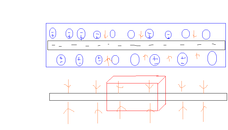

I´m back and I insist with a previous idea. Can you draw some field lines in red and the closed surface in blue? (##\vec D## and ##\vec E## point in the same direction)
All right, I did it , but I'm not sure what should I see.
Since the charged part is negatively charged the field point inward.
I don't know what I'm looking for. I guess top = - bottom, I don't know.

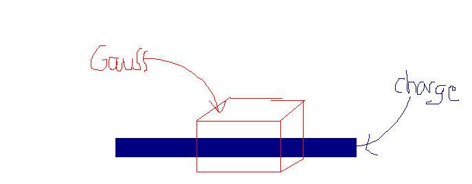

I'm using a gaussian pillbox.
Now try to "see" ##\oint_S {\vec D \cdot d\vec S}##

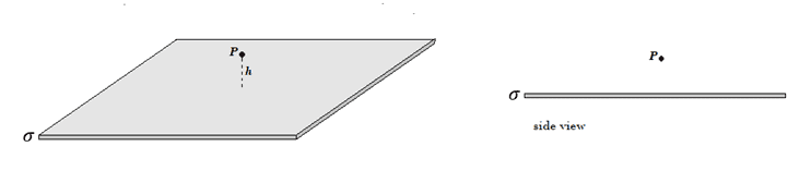

It might be helpful for you to review the standard problem of finding the electric field of an infinite plane sheet with surface charge density ##\sigma##. How would you construct a Gaussian surface to find ##E## at point ##P##?
I think cube or cylinder works, but cylinder seems easier?
##D \hat{y} \cdot A \hat{y} + D (-\hat{y}) \cdot A (-\hat{y}) = Q##
##D = \frac{\sigma}{2}##
I draw something, but I have to do with my mouse so it's ugly. This is how I see the system.
Ok.
At what point or points in the system does D have this magnitude?
What are you going to use for ##\sigma##? The electrons are spread throughout a volume rather than spread over a surface.
