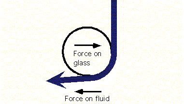

The natural question is "how does the wing divert the air down?" When a moving fluid, such as air or water, comes into contact with a curved surface it will try to follow that surface. To demonstrate this effect, hold a water glass horizontally under a faucet such that a small stream of water just touches the side of the glass. Instead of flowing straight down, the presence of the glass causes the water to wrap around the glass as is shown in figure 8. This tendency of fluids to follow a curved surface is known as the Coanda effect. From Newton’s first law we know that for the fluid to bend there must be a force acting on it. From Newton’s third law we know that the fluid must put an equal and opposite force on the object which caused the fluid to bend. (The article used this diagram )
Why should a fluid follow a curved surface? The answer is viscosity; the resistance to flow which also gives the air a kind of "stickiness". Viscosity in air is very small but it is enough for the air molecules to want to stick to the surface. At the surface the relative velocity between the surface and the nearest air molecules is exactly zero. (That is why one cannot hose the dust off of a car and why there is dust on the backside of the fans in a wind tunnel.) Just above the surface the fluid has some small velocity. The farther one goes from the surface the faster the fluid is moving until the external velocity is reached (note that this occurs in less than an inch). Because the fluid near the surface has a change in velocity, the fluid flow is bent towards the surface. Unless the bend is too tight, the fluid will follow the surface. This volume of air around the wing that appears to be partially stuck to the wing is called the "boundary layer".

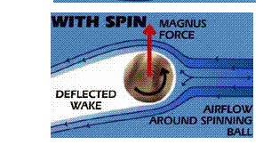

1) So based on what was said above regarding Newton’s first law “From Newton’s first law we know that for the fluid to bend there must be a force acting on it.” In the case of a spinning baseball (like in the diagram bellow) the force being referred to in the quote would be the force of the spinning baseball on the airstream?

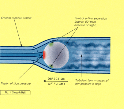

a) So would the reasons for the air separating at the points of separation on the baseball (as seen in the diagram below) be because “the bend (after the half way point the ball) is to tight”?
b) now it was the second part of the excerpt that got me a little confused “The forces necessary to bend the air to such a steep angle are greater than the viscosity of the air will support, and the air begins to separate from the wing.”
So is the article saying that the force that the wing is exerting on the air to try to make the air bend (at such a steep angle) greater then the force the viscosity of the air can support, and that is why the air separates? Similarly in the case of a baseball as seen in this next diagram below (the ball is not spinning by the way) is the force that the ball is exerting on the airflow to try to make it bend around the ball greater then the viscosity of the air will support and that is why the airflow seperates?

The force being referred to here is FRICTION. Viscosity is something like the friction coefficient you get when you are considering a solid surface. There is the famous Newton's law of viscosity that state Shear Stress [N/m^2]=viscosity*Normal_Velocity_Gradient. So the fluid encounters frictional force as it moves past a solid body. If this frictional force is not large enough to make the fluid follow the contours of the surface, then separation occurs.
