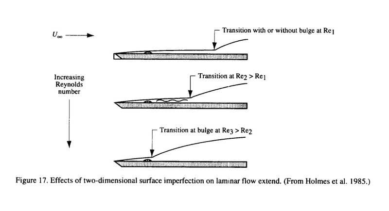

can anyone explain the physics behind surface roughness affecting boundary layers and flow separation?
I was reading an article and it mentioned that surface roughness can affect boundary layer transition? How? I am just a casual reader of aerodynamics but have a background in engineering can anyone explain the physics behind surface roughness affecting boundary layers and flow separation? and also, how would, say a gouge have an effect on boundary layers? I read an article from the u.s airforce:
'Surface Irregularity Effects on Laminar-Turbulent Transition - understanding the surface quality requirements for laminar flow on wings'
It mentioned rossiter and t-s waves but it didn't really make sense to me. if anyone could break it down, would be amazing

Surface roughness (or contamination with ice and insects), combined with Reynolds number, affect the boundary layer transition, by creating a sudden negative or unfavorable pressure gradient in the air flowing over the surface.
Copied from this old but well detailed NASA paper:
https://ntrs.nasa.gov/api/citations/19980232017/downloads/19980232017.pdf
"The impact of a surface imperfection (such as a rivet head) on the transition location can be viewed either by looking at the transition location as a function of imperfection size for a fixed unit Reynolds number or by keeping the size of the imperfection fixed and looking at transition location as a function of unit Reynolds number. The illustration in figure 17(Holmes et al. 1985) depicts the latter case, where the amount of laminar flow is decreased as Reynolds number is increased. The problem is then to determine what roughness height and shape for a given Reynolds number will cause a reduction in the amount of laminar flow obtainable. In either case, the imperfection stimulates eigenmodes in the boundary layer; the linear stability of the flow dictates whether these modes will grow or decay as they evolve in the flow. However, as the height of the imperfection or unit Reynolds number increases, a point is reached when flow separation occurs because of the surface imperfection."

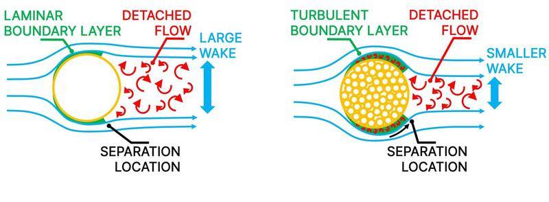

When the laminar flow breaks down, the fluid begins to tumble down on the surface of the object.
By having a rougher surface, these small disturbances tumbling down tend to bring the flow back to the surface. (Imagine the fluid being over a sticky rolling barrel and following its surface as it rolls down.)
Finding the sweet spot between higher roughness and large disruptions, you can extend further the distance where the flow will separate and become fully turbulent.
The best example is the golf ball with and without dimples:
Actually, except in the case of very large surface irregularity, the effect has little or nothing to do with pressure gradient.
The full answer here is rather complex and still an active area of study. It also depends on the nature of the roughness in question. Isolated roughness is different from distributed random roughness, which is different from periodic roughness.
The short answer is that boundary layers transition due to the growth (and eventual breakdown) or unstable waves that propagate through them. The transition location is determined, among other things, by the initial amplitude of these waves. The initial amplitude of the waves is determined by a process called receptivity through which unsteady disturbances in the free stream interact with a surface to produce unsteady disturbances in the boundary layer. One of the primary mechanisms for this receptivity process is the interaction of surface roughness with free-stream disturbances to produce waves that can grow and eventually transition to turbulence. [1]
In essence, larger roughness produces larger initial amplitudes for the waves that are then subject to boundary-layer instability. That means they reach a critical amplitude and transition sooner.
This is why dimples on golf balls produces turbulent flow sooner than a smooth ball, which resists separation, producing a smaller wake and lowering overall drag (even though viscous drag increases).
References:
[1] Saric, WS, Reed, HL, Kerschen, EJ. 2002. "Boundary-Layer Receptivity to Freestream Disturbances." Annual Review of Fluid Mechanics. 34. pp. 291-319. doi: 10.1146/annurev.fluid.34.082701.161921

Some of the idea behind golf ball dimples absolutely works on wings. No rotation necessary. Roughness on a wing will encourage turbulent flow. Turbulent flow is more resistant to separation, so you are less likely to get separation and stall on a wing if the flow is turbulent. However, a far smaller percentage of drag on a wing is due to the size of the separated wake when compared to a sphere, so delaying separation has very little impact on drag on an airfoil in most practical cases. Therefore, causing transition on a wing usually makes total drag go up, not down, because of the dramatic increase in viscous drag. You would therefore usually rather have a laminar wing during steady flight (cruise).
Sometimes it's better to have turbulent flow, though, such as when performing maneuvers requiring high angle of attack or during takeoff and landing. In those situations, the wing is often operating much closer to stall so having turbulent flow will help the boundary layer resist that.
