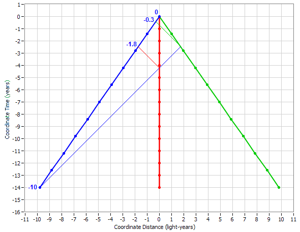

We start with what you started with, the rest IRF of star X which is shown as the thick red line. The first spacecraft is shown in blue going to the right and the second spacecraft is green going to the left. You should be able to verify that their speeds are 0.7c because in 10 years they progress through 7 light-years. The dots on each worldline mark off one-year increments of each object's time. The faster they go, the farther apart the dots are compared to the Coordinate Time:
Spacetime diagram with coordinate distance in light-years on the horizontal axis and coordinate time in years on the vertical axis; a thick red vertical line marks distance 0, blue and green worldlines form a V shape from the origin, and a thin red line and blue line mark labelled points -1.8, -0.3 and -10.
Now I want to show you how the pilot of the first spacecraft can measure the speed of star X relative to himself and then how he can measure the speed of the other spacecraft . What he has to do is measure how far away each object is at some particular time. Then he has to do it again at some later time. Then he can calculate the speed of the object by dividing the difference in the distance measurements by the difference in the time measurements.
So how does he make the required measurements? He uses radar signals which bounce off the object of interest. He keeps track of his time when the radar signal was sent and his time of when the reflection was received. By dividing the difference in the times by two, he assumes that the signal took the same amount of time to get to the object as it took for the reflection to get back (Einstein's convention) and assumes that the distance is how far the signal would progress at the speed of light.
Then for the time at which the distance measurement is made, he simply takes the average of the two times.
He could repeat the process again but since the spacecraft eventually will arrive at star X, we can use the time at which the distance is zero as the second point.
So let's see what the pilot gets. It is customary to synchronize all the clocks so that they are at zero when they get to the origin of the IRF so I have marked in the important times for the pilot. We'll focus first on the measurement for star X. I think you can see that the radar signal was emitted at the pilot's time of -10 years and he receives the reflection at his time of -1.8 years. The average is -5.9 years. The difference is 8.2 years and half that is 4.2 years so he establishes that star X was 4.2 light-years away at his time of -5.9 years. Since its distance at time zero is zero, he establishes the speed to be 4.2 light-years divided by 5.9 years or 0.71c, close enough for eyeballing the times off the diagram.
Now for his calculation of the speed of the other spacecraft , we use the same radar sent time of -10 years but the reflection received time of -0.3 years. The average is -5.15 years and the distance measurement is 9.7/2 = 4.85 light-years so the speed is 0.94c. This is the same value that Drakkith reported in post #4.

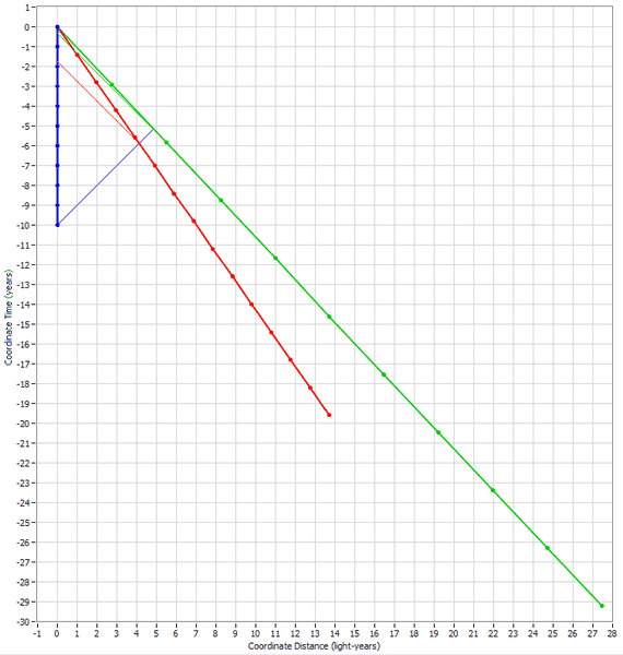

But we can also use the Lorentz Transformation to determine the speeds as shown in this diagram for the rest IRF of the first spacecraft :
Spacetime diagram with coordinate time in years on the vertical axis and coordinate distance in light-years on the horizontal axis; a thick red worldline runs diagonally down to the right, a blue line goes up-right from the origin, and a green line runs down-right.
Now, because the spacecraft is at rest in this IRF, the Coordinate Distances match the measurements that the pilot made.
Does this make perfect sense to you? Any questions?
  • Spacetime diagram with coordinate distance in light-years on the horizontal axis and coordinate time in years on the vertical axis. A thick red vertical line sits at distance 0, with a blue line going up-left and a green line going up-right meeting at the origin.
  • Spacetime diagram with coordinate time in years on the vertical axis and coordinate distance in light-years on the horizontal axis; a thick red worldline runs diagonally down to the right, a blue line runs up-right from the origin, and a green line runs down-right.
