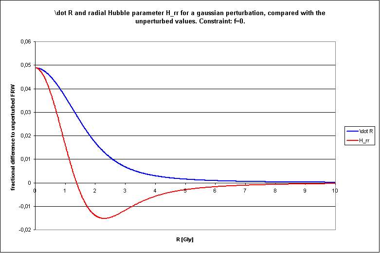

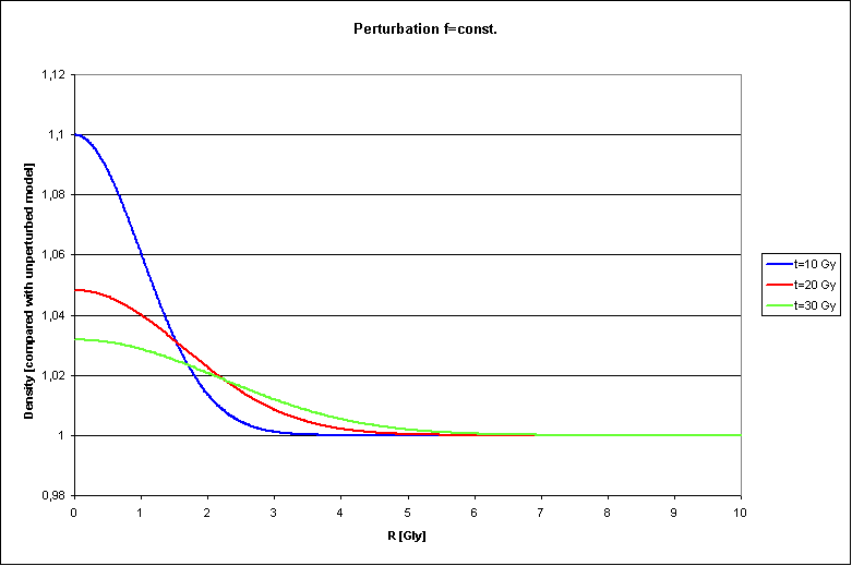

I think I've made some progress with the LTB dust. In fact, when I combined the knowledge from this thread with that in the http://en.wikipedia.org/wiki/LTB_dusts" article, everything suddenly made so much sense that I got suspicious again. Maybe you can check what I'm writing here, it'd really be a pity if I misunderstood something or had wrong information - I know you're wary of Wikipedia.
First important thing: the constant f equals 2E, with E the total specific energy of a particle in a given shell. That makes sense, as it corresponds to the open/flat/closed - ever expanding/recollapsing thing for matter dominated FRW models. Remarkably, in LTB coordinates, the expression for energy is formally identical to the Newtonian one:
[tex]E=\dot R^2 /2 - M/R[/tex]
where M is all the mass enclosed by said shell.
Combined with the https://www.physicsforums.com/showthread.php?p=2657769#post2657769"
[tex]R_{tt} = \frac{f - R_t^2}{2 \, R}[/tex]
we get the extraordinarily simple equation
[tex]\ddot R = -M/R^2[/tex]
So we see three things:
1. We're dealing with a formally Newtonian model (some subtleties aside)
2. The universe outside a given shell is completely irrelevant (Birkhoff)
3. The universe inside a given shell is completely described by one number, its mass (also Birkhoff)
If there is a local overdensity in a spatially flat (i.e. zero total energy) universe, we can see from the energy equation that indeed (itex]\rho\propto H^2[/itex], and one suspects that this is the reason for the counterintuitive behaviour (dilution) of said inhomogeneity for two reasons:
1. The faster expansion will naturally dilute the overdensity.
2. A spatially flat universe is described by one number, its age. An overdensity means a universe that is some dt younger compared to the outside universe far away. Both follow FRW laws and keep being synchronized, so said dt becomes less important as the universes evolve, and the overdensity vanishes.

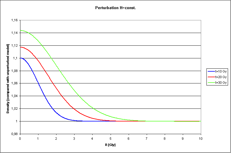

I made some simulations for a (initially) flat universe 10 Gy old, with a 10% gaussian overdensity of 1 Gly radius at that time. I started it with two different initial conditions:
1. Overall spatial flatness, E=f=0. That means, H larger in the overdensity.
2. Same Hubble parameter everywhere (that's a tricky one, btw, as H is defined on proper distance, not LTB's R). That means, E<0 in the overdensity.
From E<0 in the second case, one sees that the inhomogeneity will finally collapse, which is the expected behaviour.
I attached the respective diagrams.

That sounds basically correct.
This energy is constant on a specific shell r=r_0, but (for a generic LTB dust solution) varies with r.
  • The faster expansion will naturally dilute the overdensity.
  • A spatially flat universe is described by one number, its age. An overdensity means a universe that is some dt younger compared to the outside universe far away. Both follow FRW laws and keep being synchronized, so said dt becomes less important as the universes evolve, and the overdensity vanishes.
I think that is what I was saying? Except that the LTB dusts representing spherical perturbation of an FRW dust with E^3 hyperslices include perturbations which retain the locally flat hyperslices property, and then the age varies from shell to shell.

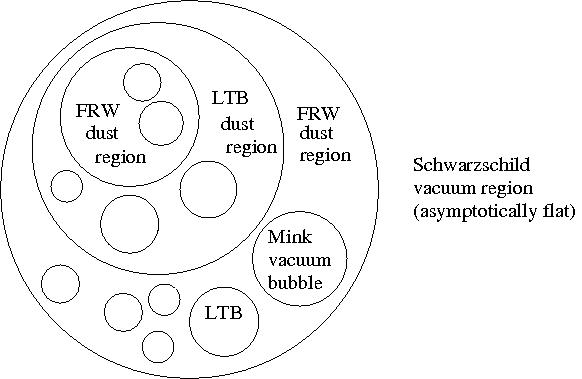

I remarked that the LTB dusts deserve a thread of their own. Excellent background reading for cosmology generally: Ellis & Elst, Cosmological Models, http://arxiv.org/abs/gr-qc/9812046. And an excellent chapter (!) on LTB dusts can be found in the textbook by the late Jerzy Plebański and Andrzej Krasiński, An Introduction to General Relativity and Cosmology, Cambridge University Press, 2006. Unfortunately, as I write, I do not have this book at hand.
First, your constraint equation is just a first integral of the one I gave, and it is pretty standard. The Wikipedia article appears to be based upon the discussion near (15.33) in the monograph by Stephani et al., Exact Solutions of Einstein's Field Equations, Cambridge University Press, 2003. The form of the metric is due to Tolman, IIRC, but AFAIK the first integral is due to Bondi, as I think I mentioned.
Second, the LTB dusts include exact dust solutions for which roughly speaking we can envisage the matter as expanding/contracting S^2, E^2, and H^2 shells of dust. The case I discusssed is of course the one in which the matter consists of expanding or constracting S^2 shells. Here, the expanding case gives cosmological models (with a well defined family of hyperslices orthogonal to the world lines of the dust particles) which can thought of as spherical perturbations of FRW dusts (which are, in terms of the spatial hyperslices orthogonal to the world lines of the dust particles, homogeneous and isotropic). The contracting case can be thought of as models of spherically symmetric gravitational collapse of pressureless matter (somewhat dubious at large densities, of course). I focused in particular on the case when the hyperslices are locally flat.
Third, in more detail, the form of the line element given in Stephani et al. for the comoving chart is basically this:

Yes, you had a decaying overdensity. The reason for the decay was not so clear, as you identified two contributions of inward streaming matter (gravitational attraction and a "radial streaming"), but none outward. It seems now that the "streaming" is rather outward, due to the E=const condition.
Can you make png images instead of pdf?
Yes, attached.

from https://www.physicsforums.com/showthread.php?p=2688487#post2688487":
Ich said:
If there is a local overdensity in a spatially flat (i.e. zero total energy) universe, we can see from the energy equation that indeed [itex]\rho\propto H^2[/itex]
I assume that by H you mean the diagonal components of the expansion tensor in the FRW background.
"H" means - in my numerical solution - velocity difference times distance in radial direction. For consecutive shells i-1, i:
[tex]H = \frac{\dot R_i-\dot R_{i-1}}{R_i-R_{i-1}}\sqrt{1+2\epsilon}[/tex]
Now that I'm writing this I'm no longer sure this is correct. It was meant to reproduce locally the operational definition of H, therefore reproducing the FRW values in a homogeneous universe. But I think I can drop the sqrt-factor?

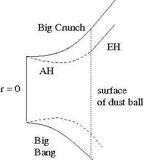

The simplest interesting example is a collapsing Oppenheimer-Snyder dust ball, for which we can take,
[tex] \begin{array}{rcl}<br /> ds^2 & = & -dt^2 + \frac{(R^\prime)^2}{1 + 2 \, \epsilon} \; dr^2 + R^2 \, d\Omega^2, \\<br /> && R = \left( \frac{9m}{2} \right)^{1/3} \; (b-t)^{2/3}, \\<br /> && -\infty < t < t_{\rm max}<br /> \end{array}[/tex]
where m,b are given by
[tex] \begin{cases}<br /> m = m_0 \, r^3, \; b = 0 & 0 < r < r_0 \\<br /> m = m_0, \; b = r & r_0 < r < \infty<br /> \end{cases}<br /> \right.[/tex]
where [itex]r=r_0[/itex] is the surface of the collapsing dust ball.
Notice that R is continuous but not C^1 at r=r_0. Because the density suddenly jumps from zero to a nonzero value at the surface of the dust ball, so the curvature tensors will jump there too, while the metric tensor is continuous there. This is fine. From the figure (see below), you can see that
  • the shells are collapsing (as time increases, each world sheet crosses contours corresponding to decreasing R),
  • shells of dust in the dust region collapse slower than shells of Lematire observers in the vacuum region, because these shells only enclose a portion of the total mass of the dust ball (and no shell cares about shells further out), so the contours of R bend upward as we enter the dust region,
  • all the shells collapse to R=0 at the same time, t=0.

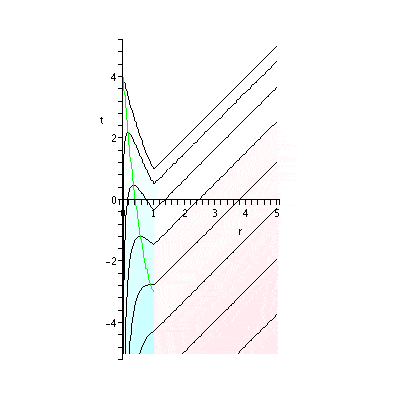

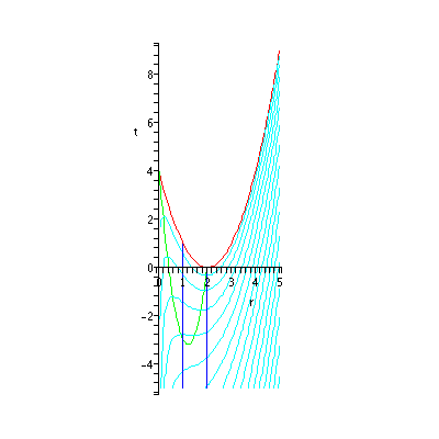

A slightly more elaborate example, with density varying over the spherical shells, was given by Yodzis, Seifert, and Muller zum Hagen:
[tex] R = (9 \,m/2)^{1/3} \; (b-t)^{2/3}, \; \;<br /> m = r, \; \;<br /> b = (r-r_0)^2[/tex]
This example illustrates a shell-crossing singularity; see the figure below and note these features:
  • different shells collapse at different times to the final singularity at R=0 (red curve),
  • the contours of R show that the dust particle at r=0 lies at the geometric center R=0 for all time,
  • shells with small r fall in rather slowly,
  • the shell crossing singularity (green curve) is the locus where [itex]R^\prime = 0[/itex], i.e. where the contour lines go horizontal.
The shell-crossing singularity arises here because the outer shells are more dense, so they actually collapse faster and eventually catch up with inner shells and form a "density caustic", which is the shell-crossing singularity.

Figures: some LTB dusts plotting in Lemaitre-Tolman comoving chart; left to right:
  • Expanding OS dust ball (oops!--- reverse time to get collapsing OS dust ball), removed for rennovation![/color]
  • YSM example of a collapsing LTB dust with spherical shells and E^3 hyperslices,
  • the same, matched across a surface to a Schwarzschild exterior. removed for rennovation![/color]
In the leftmost figure, dust region in cyan, vacuum region in pink, initial singularity at t=0. In the rightmost two figures, final singularity in red, shell crossing singularity in green, contours of R in blue (dust region) and pink (vacuum region). In the rightmost figure, the world sheet of the surface of the collapsing dust ball is shown in black. In all three figures, we also plot some world lines of dust particles (blue) and Lemaitre observers (gold).
I still haven't had a chance yet to re-examine the post in the other thread on "streaming", so I don't yet know whether I want to retract anything. I am confident I didn't make any computational errors, but I might have erred in the nontrivial function of interpretation of the results of my computations! So stay tuned...
Yes, attached.
Mebbe try again? I am not seeing the attachments.

Yes, I misspoke, sorry. (For others: these terms are based upon the formal Newtonian analogy, in which energy = KE + PE is constant for a particle attracted by a Coulomb type gravitational potential.)
H should not be a single number in an inhomogeneous dust! The Hubble expansion is correctly described by giving the expansion tensor (components taken wrt a nonspinning inertial frame field corresponding to the dust particles).

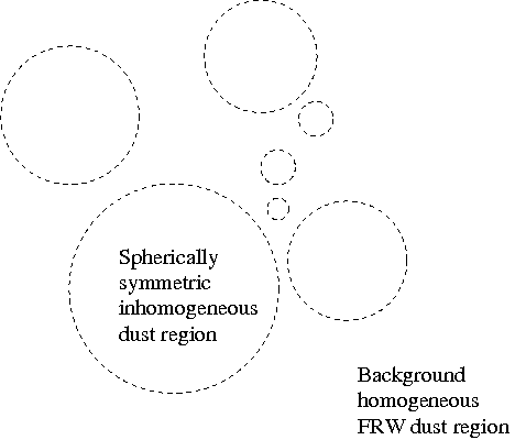

Some examples of LTB dusts with spherical shells having various energies
Once we drop the requirement that the hyperslices be locally flat, we can really go to town.
One thing we can immediately do is to take any FRW dust and excise a number of world tubes, each bounded by the world sheet of a spherical shell of dust, and then match across the world sheets of each shell to a suitable LTB dust (each spherically symmetrical within its own little region), to obtain a variety of "Swiss cheese" type models.

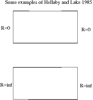

Returning to dust solutions with global spherical symmetry, Hellaby and Lake 1985 gave two particularly interesting examples of LTB dusts with spherical shells. The first, which we can call "HL two center LTB dust", is a (mostly) expanding LTB dust defined by taking
[tex] m = m_0 \, r^3 \, (\ell-r)^3, \; \;<br /> \epsilon = \epsilon_0 \, r^2 \, (\ell-r)^2 \, (\lambda \, r - 1) \, (\lambda \, (\ell-r) - 1), \; \;<br /> 0 < r < \ell[/tex]
(all constants positive with [itex]\lambda > 2/\ell[/itex]) in the constraint equation
[tex] \dot{R}^2/2 = \frac{m}{R} + \epsilon[/tex]
Note that the energy of the shells is given by a sextic polynomial with two negative minima flanking a positive maximum, so we have a region of positive energy shells which expand forever, and two regions of negative energy shells each recollapsing to a different center R=0, corresponding to the labels [itex]r=0, \; r=\ell[/itex]. I'll leave it as an exercise to study the geometry of the spatial hyperslices t=t_0 to see how we can have the two regions filled with negative energy spherical shells of dust each collapse to its own "center of spherical symmetry".
The second example, which we can call "HL two-sheet LTB dust", is given by taking
[tex] m = (m_0 - m_1 \, r^3)/2, \; \;<br /> \epsilon = -(1-\lambda \, r^2)/2, \; \;<br /> -\infty < r < \infty[/tex]
in the constraint equation. This includes
  • a region containing shells which collapse from infinite surface area to a Big Crunch, with [itex]r=-\infty[/itex] corresponding to a sphere of infinite surface area,
  • a region containing shells which expand forever from a Big Bang, with [itex]r=\infty[/itex] corresponding to a sphere of infinite surface area,
  • an interpolating region containing shells of negative energy which expand from a Big Bang, halt, and recollapse to a Big Crunch
Again, I'll leave it as an exercise to study how the geometry of the spatial hyperslices t=t_0 evolve as time increases.

Figures: left to right:
  • Carter-Penrose diagrams (heavy lines correspond to strong curvature singularities) illustrating two examples of Hellaby and Lake 1985
    • top: HL two-center LTB dust,
    • bottom: HL two-sheet LTB dust,
  • the Hellaby "string of beads" LTB dust; schematic figure depicting the Lemaitre-Tolman comoving chart with world lines of some shells of dust shown as solid vertical line segments and hyperslices t=t_0 shown as horizontal dotted lines.
Strange. I'm sure I uploaded them. Anyway, I try again.
H is H_rr. That's the most interesting, as I set it as an initial condition. The tangential components are relatively simple, if I'm not mistaken (maybe you can check?):
[tex]H_{\theta}=\frac{\dot R}{R}\sqrt{1+2\epsilon}[/tex]
I'll write more on H_rr soon, I think I'm about to understand a bit more again.

Your left figure, the case [itex]\epsilon=0[/itex], looks like mine, which may or may not be good (more in a moment). Re your right figure, in your Post #7, you wrote
Not sure what you mean by "proper distance"; as I have tried to emphasize (it can never be repeated too often) there is no single preferred notion of distance in the large for a Riemannian or Lorentzian manifold, in general. R is the Schwarzschild radial coordinate, so A = 4 \pi R(t_0,r_0)^2 is the surface area of the spherical shell r=r_0.

Well, there's a problem: I don't know what I mean - let me explain what I meant to mean:
I'm trying to follow the operational definition of H, that is dv/dx as seen by a comoving observer. As we're using proper time for these observers anyway, I thought it was necessary to use the according proper distance also (which is unproblematic, as I evaluate H in the limit dx->0). The local orthonormal frame.
However, since v and x scale the same way, it's ok to use [itex]d\dotR/dR[/itex]. By this reasoning, it should make no difference in this case whether I use the frame field or the coordinate basis. If it does, I haven't understood something.

Sorry, I think there's a misunderstanding. I meant the tangential parts of the expansion tensor, which I think should be [itex]\frac{\dot R}{R}\sqrt{1+2\epsilon}[/itex]. wrt the frame field, I guess, so that \theta was a misnomer. But I see that you don't have the \sqrt term, so I better rethink what I'm doing here.
[tex] H_{22}=\frac{ -\frac{m}{R^2} + \frac{m^\prime/R^\prime}{R} + \epsilon^\prime/R^\prime}{\sqrt{2} \, \sqrt{m/R + \epsilon}}[/tex]
Yes, that's the interesting formula. I gained some more understanding from expressing it in terms of specific kinetic energy ke:
[tex]H_{22}=\frac{dv}{dke}{dke}{dr}=1/\dotR(\frac{d\epsilon}{dR}+\frac{d(M/R)}{dR})[/tex]
