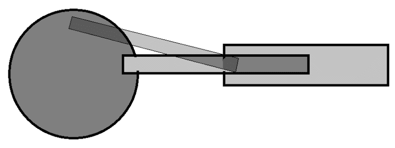

Building a better crankshaft (crank and slider)
The discussion revolves around the design and improvement of a dual input crankshaft, specifically for a single-cylinder engine, using Lego as a medium. Participants explore the limitations of traditional crankshafts, particularly their tendency to jam under linear input, and seek innovative solutions that do not rely on flywheels.
  • One participant identifies the issue with current crankshafts, noting that they often jam due to limited rotation and material warping, and expresses a desire for a more efficient design without flywheels.
  • Another participant suggests using inertia to overcome the jamming issue, questioning the original poster's resistance to this solution.
  • Some participants inquire about the specifics of the proposed dual input crankshaft design, asking for diagrams and clarifications on terminology.
  • There are discussions about the mechanics of sine waves and their relation to crankshaft design, with some participants questioning the feasibility of a single-cylinder engine without a flywheel.
  • One participant emphasizes the importance of understanding existing technologies before attempting to innovate, suggesting that historical research could inform better designs.
  • Another participant argues that while alternatives to flywheels could be invented, defining what constitutes a "better" solution is essential.
  • Concerns are raised about the practicality of creating a flywheel-free, single-cylinder engine, with one participant suggesting that achieving this would be a significant challenge given the advancements made in engine design over the years.
Participants express a range of views on the feasibility of improving crankshaft design without flywheels. While some propose alternative mechanisms, others challenge the practicality and necessity of such innovations, indicating that the discussion remains unresolved with multiple competing perspectives.
Participants note the limitations of existing crankshaft designs and the inherent challenges in creating a more efficient mechanism. There is an acknowledgment of the complexity involved in engine design, particularly regarding the number of pistons and the mechanics of power strokes.

I just watched the video linked in the original post #1. At best, it makes up its own terminology ("input," "cam"...). It is misleading as well. The stroke of the piston is determined by the throw of the crank, calling this the "semi major axis of the cam" only obfuscates what is going on. It isn't entirely incorrect, and might have some use if the device under consideration was say a cam opening a valve, but that is normally done with a follower and pushrod, or the cam acting directly on the valve stem, neither of which is a slider-crank mechanism. Finally the notion that the piston ("slider") cannot drive the crank's rotary motion can be put to bed by considering the millions of piston engines happily running since the dawn of the industrial revolution.
  • #34
Do you have a better video to suggest? I did not intend for this video to be the "holy grail" of crankshafts just as a quick example to illustrate a problem. I also said several times (actually one of the first things I said) that of course with a flywheel the problem can be solved, and motion can be achieved, but that I was not interested in using a flywheel.

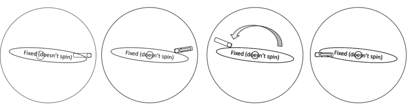

The doodle is complete but I fear that without animating it in some way it is going to appear as utter nonsense...
I will try and make a gif for it later if I get the time!
I will also say that this will likely make a very poor engine as I think it will result in the speed juddering all over the place... but it could negate the need for a flywheel, anyway!

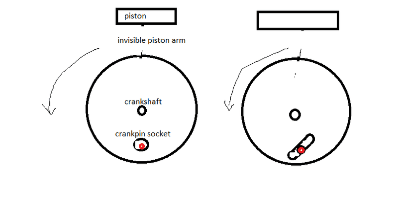

okay... so, you've got
- a big circle, featuring
- a little circle near the edge.
Make the little circle a slot : same placement, same width but say a length of 3x, the diameter of the original. Angled, as measured at BDC(or TDC), at 45deg.
Works fine in 2d ; probably too messy in 3d, but might give you something to work off of.

Hmm, can you draw me a rough sketch, I'm not quite sure what the visualization of this is. Are you saying to cut a slot into the gear, put the conrod into the slot, or something else?
  • #52
Something like...
The first one is normal, it's the one you have issue with. The second one uses a slot, not a circular hole, to hold the crankpin.
  • #53
hmmm27 said:
Something like...
View attachment 285613The first one is normal, it's the one you have issue with. The second one uses a slot, not a circular hole, to hold the crankpin.
What happens at the top of the stroke?
  • #54
Same as what happens at the bottom... except upside-down. 45deg before tdc/bdc, the pin switches from the inside end of the slot to the outside.

#55[edit: #52] * idea does rely on inertia ; if the piston-arm is comparatively too heavy, you'll still be stuck.

I tried post #52 it in the sim, it works if the friction is low, but if there is a decent amount of friction it won't work, gets stuck when the diagonal is in the outer region. Post #55 contains different concepts so idk which one you are referring to.

Sry, meant #52, not #55. post amended. Given length of slot was for an example, not a calculation.

Yes, this was similar to my first thought before I dismissed it for the same reasons!
The trick is finding a way to have 2 cranks which can be turned by a single con-rod. That's where my design came in, though I am struggling to find a way to make it on any online gear generators - none of them assume a gear is fixed and the rest rotate around it!

Hmm can you edit your diagram because I'm a bit confused about it.
