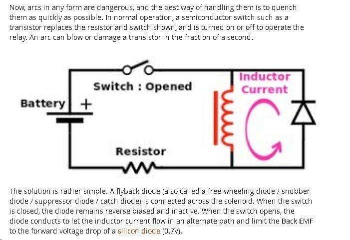

jim hardy said:
Don't forget that inductive kick reverses polarity.
When the switch opens
instead of current being pushed through the pump motor by the battery
the pump motor now tries to suck current through the switch, which of course it can't, and the only place it can get it from is backward out of the fans.
A motor's inductance can make a lot of voltage trying to do that.A flywheel diode let's the motor suck current , harmlessly circulating it around through the diode, with only one diode drop (-0.6V) which won't hurt anything.
https://www.westfloridacomponents.com/blog/what-is-back-emf-and-what-does-it-do/

iduhfuse said:
I like the idea of this, but if I'm understanding this correctly...the idea is my fans would not be getting power?
no, all you do is add a diode to the pump
so that it doesn't throw an inductive fit when power is switched off

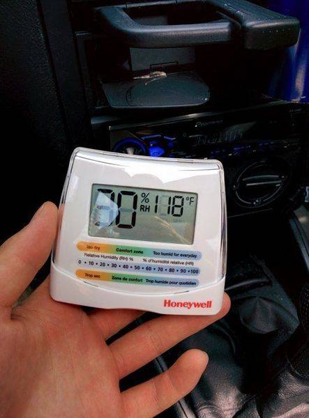

I live in Toronto, Canada. So yeah weather probably does state dewpoint most likely. Humidity RH was 36% in the car. And no zero leaks
Toronto ! wow...
I typed 95 F and 36% into this
http://andrew.rsmas.miami.edu/bmcnoldy/Humidity.html
and got dewpoint 64 degF
The air coming out of your radiator probably will only creep below that as the car dehydrates . Fortunately you're not having to dry outside air.
Fun project, keep us posted ?

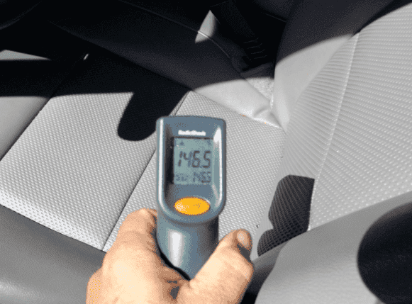

I measured temp using an infrared heat gun. Shoots a laser...I've basically concluded this little experiment is a bust. It was fun, $120 sort of wasted (I can use parts for other things) but otherwise this AC cooler is not effective at all. Guess just have to deal with the heat or either pump that water through a vest...which is tempting

I don't know what other data to provide. Even without doing quantitative data analysis it's pretty simple to tell "omg. It's ******* hot!" ...and then proceed to roll all windows down and get a blast of fresh cool air lol. All jokes aside...I already know my bottleneck. My heat exchanger is way to small and fans are not powerful enough (also need more of them). If I could get a heat exchanger to cover the entire lid of the cooler with maybe 9 fans running then yes it would probably make 20-30f difference instead of only 5-10f difference. However, heat exchangers are expensive and I don't plan on spending any more on the project other than maybe using an old life jacket and running water lines through it to cool me
