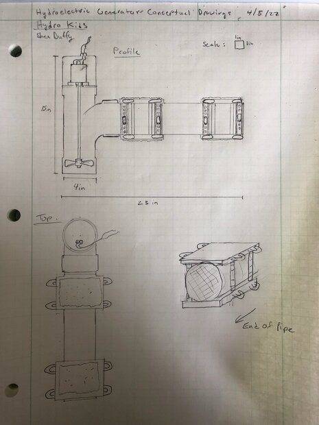

The system would be placed in a shallow creek or small river. I've attached a conceptual drawing that should help.

There are existing products for this application. Can you post links to those products and address what their design decisions were? :smile:

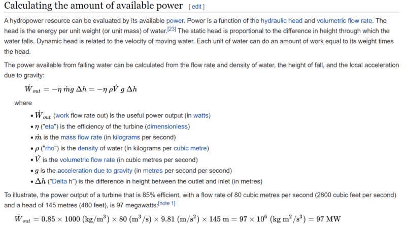

The equations you need are in post #9. It includes flow rate, not velocity.

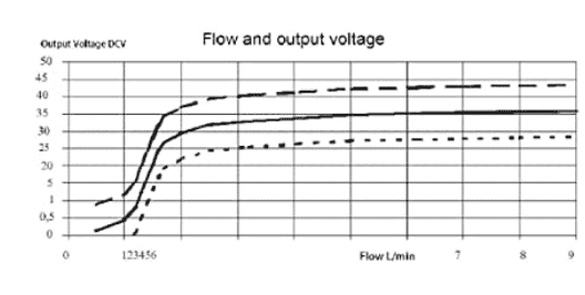

If you bought it, it might come with a data sheet that gives the parameters needed to make an analysis. For example, a similar unit's ad includes this curve.
