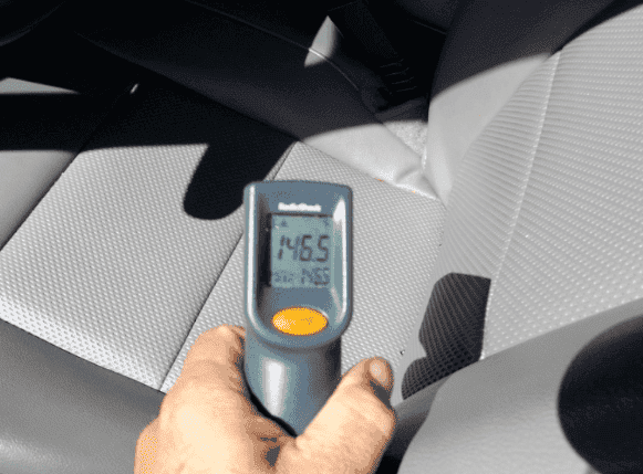

The best value of cooling effect from ice would probably involve local cooling of the driver's body with partially insulated ice packs inside the driver's clothing.
  • #37
OmCheeto said:
The sun decided to burst out early today. :partytime:
Currently collecting preliminary data.
The data does not look good. :H
Thank god I used duct tape to put everything together.

Update: Canada Post is going on strike and therefore my rad is being delayed. Son of a gun! It might be a while until you hear from me next but don't worry. There will be pics and all. Also, cig lighter is 15amps. That's easily enough to power my pump 3A + 2, 0.5A fans. Total 4 amp draw lol.
  • #40
It's been my rule to never to pay more than $20 for equipment for an experiment, unless I've done the maths first.
My electrical power draw yesterday was 24.5 watts. (solar powered, measured with separate volt and amp meters)
one water pump: 0.194 kg/sec
one air pump: 0.0185 kg/sec​
My system thermal power was 67.2 watts (based on the temperature rise of the ice/water bath)
My guess is that the water flow rate was not the problem.
Still only into this problem for about $2.

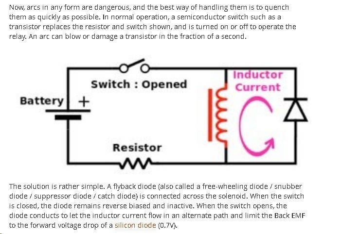

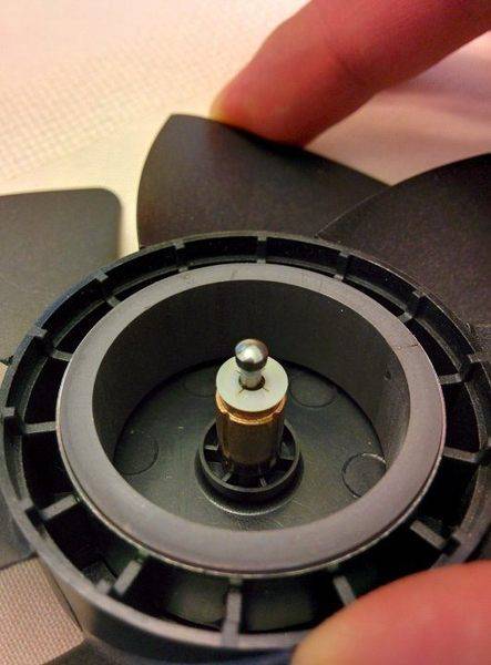

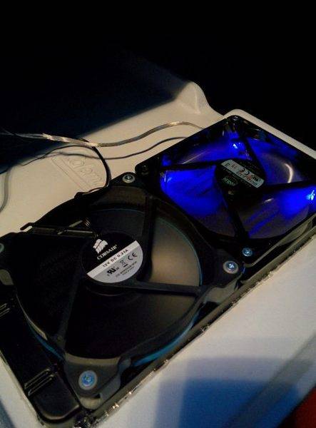

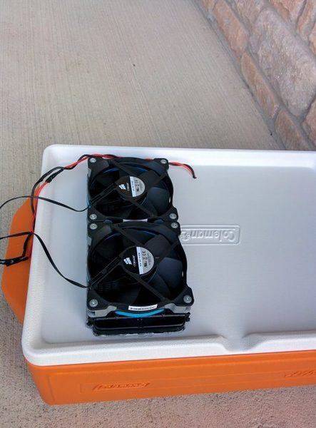

Okay it's finished! But I'm having problems
:(((...when I first flicked the switch on the pump ran and the two fans ran beautifully. Later when I adjusted everything switched it on again and one of the fans sort of took a while to turn on? Then I switched it on again later and only one fan came on. Again, now both fans are not operating ...wth?! Now, only the pump runs, I double checked all the wiring and its solid. I have no clue what's going on. Thought maybe the battery was draining so there wasn't enough voltage so I had the engine running for a bit and still both fans not operating. I'm stumped and need your help!
  • #47
Methinks the H2O entered the prime air mover. (At least that's better than the brown stuff entering the air conditioning system.:eek:))
  • #48
You think water shorted the fans? *Cries*
  • #49
First-pass guess based on next to zero knowledge. Dry 'em out, they may resuscitate. Or maybe there's just mechanical interference.
  • #50
Got a datasheet for those fans ? Any notes in it about mounting plane ? Are they brushed or electronic ?
iduhfuse said:
Fans 7-12V rated at 0.5 Amps
12 V ? Car runs 14, surely they're not that tender.
However - inductance of water pump could be generating a turn-off transient...reverse polarity spike when you flip the switch off
one of those cheap bicolor LED voltage testers would probably show, look for a green flash at turnoff
http://www.walmart.ca/en/ip/auto-voltage-tester/6000119380174try a flywheel diode ?
old jim

old jim
I checked system running at 12.36 volts (car off) with multimeter. The fans are Corsair SP 120 High performance. Also can you send me a link for a flywheel diode?...i'm seeing diagrams. I have no idea what that looks like lol. OOPS ****Another thing I forgot to mention. I did remove the pump from the circuit and tested each fan individually. They both did not work.

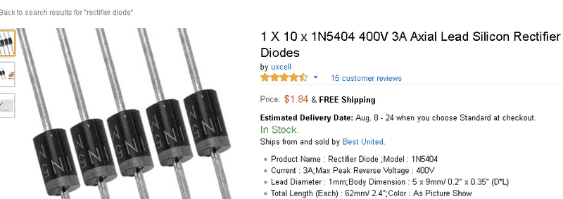

  • #52
most any diode will do
it ought to be rated for as much current as the pump draws
if it's a 1 amp pump get a handful of in4001's they're dirt cheap and everywhere
1n400X series comes in various voltages , last digit is voltage rating in hundreds 1n4001 is 100 volt, 4004 is 400 volt etc but they're only 1 amp
probably these3 amp would be fine,
https://www.amazon.com/dp/B0087YKERK/?tag=pfamazon01-20
lifetime supply for two bucks ?
it goes right across pump motor terminals
end with the stripe to positive
Are the fans polarity sensitive? Do the instructions warn against reverse voltage?
I saw inductive kick from a Harley Davidson generator kill an expensive "Electric Frank" electronic voltage regulator... it's not something all designers think of.
I hope you find something simpler like a loose crimp connection
old jim
  • #53
Good catch, Jim!
Diode: 1N4001. They are about 5 cents. Put one directly across the pump; reverse polarity so it doesn't conduct.
If that's the problem, the fans may be toast. So for good measure, the next time around, put a diode in series with with each fan.
EDIT: and a capacitor across each fan, maybe 0.1u to 0.47u.

  • #54
Don't bother with the 1N4001 diodes. Get 1N4007. They are 1000V and usually the same price as the 50V ones. If you ever need the higher voltage then you already have them. Get a bunch. Almost anywhere something just specifies a diode without any more information they will work.
For series diodes you will get better performance with Schottky diodes. It probably doesn't doesn't matter in this application but the lower forward voltage is useful for higher currents and applications where the voltage drop could be problematic. Don't use them for half wave rectification. The reverse leakage current is bad for polarized capacitors. And a bigger capacitor doesn't help. Or at least so I've been told o0)!

  • #57

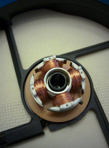

I just realized that 50V spikes are common in car electrical systems, and I wouldn't be suprised to see an occassional 100V spike. If those fans are the common 12V units sold for computers, they are brushless DC. The IC in them seems to be a Hall detector and commutator all in a 3-pin TO-92 package. Those would definitely need surge suppression/filtering on the power leads. The question is, what would be the most appropriate? Perhaps back-to-back 16V 5W zeners with a low amp fuse on the incoming power? What say, Jim?
@iduhfuse If the fans are dead, don't trash them. A post mortem would be helpful. Specifically, If there is an IC or transistor in them, let us know the part number and other markings on it. That way we can look for a data sheet and find out what their voltage rating is.
  • #58
Tom.G said:
What say, Jim?
Don't forget that inductive kick reverses polarity.
When the switch opens
instead of current being pushed through the pump motor by the battery
the pump motor now tries to suck current through the switch, which of course it can't, and the only place it can get it from is backward out of the fans.
A motor's inductance can make a lot of voltage trying to do that.A flywheel diode let's the motor suck current , harmlessly circulating it around through the diode, with only one diode drop (-0.6V) which won't hurt anything.
