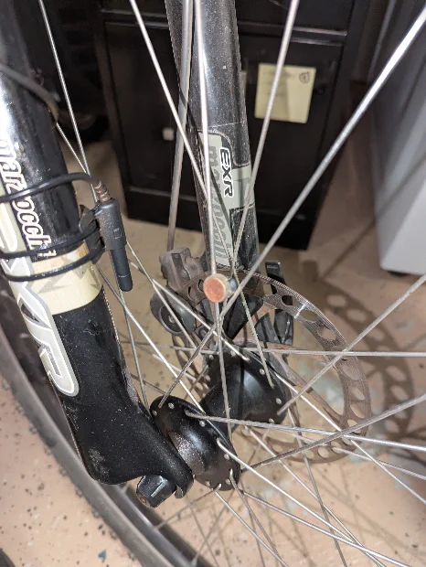

* i dont know who to attach the reed switch and magnet. i can like attach magnet using m-seal but reed switch must be conected to board so two long wires must be connected to shock absorber to handlebar(where the speedometer will obvious be)

* i dont know who how to attach the reed switch and magnet. i can like attach magnet using m-seal but reed switch must be conected to board so two long wires must be connected to shock absorber to handlebar(where the speedometer will obvious be)
I'll attach a picture of my MTB speedometer magnet and pickup below. The magnet has a screw that attaches it to one of the spokes on the front wheel; you can buy them at pretty much any bicycle shop. The pickup element like your reed switch is cable-tied to the front fork leg and the cable is routed up the right fork to the handlebars. There is enough extra wire length to allow for accommodating the varying length of the fork leg as I ride.

The software programming is pretty well the easiest part of your project. Your main problem is what to contain the electronics in and how to secure it all. You will need a display and buttons unless you intend to use your phone to control it all. Your container and the wiring needs to ve VERY waterproof, vibration proof and impact proof. (Look at bike computers that are available, for useful ideas. You will need to be (or become) good at mechanical assembly so that your device will last long enough to have time for all the analysis you propose. Bits of string and electrical tape may not be enough to allow you to detach the system and take it indoors to modify it, charge it and read the data etc.
I include this link to show you the sort of care that's involved in a small part of a proper rugged project. Please do a lot of research and reading before making any decisions about your design; avoid disappointment at a late stage. I've been there many times and 'half way along' modifications can be a real pain.
Good luck but 'look before you leap'.

yes the software part is easy as i am a cse i am familiar with the software as of the hardware part i just burned my oled screen by not grounding the sceen. there was a loose connection without checking it i connected to the powersource and my 20% of my project budget went to vain which is sad. and making the product durable and all terrain is a big challenge hope i can finish it
