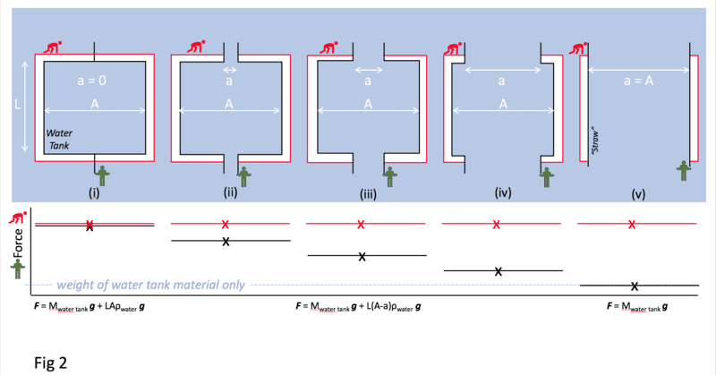

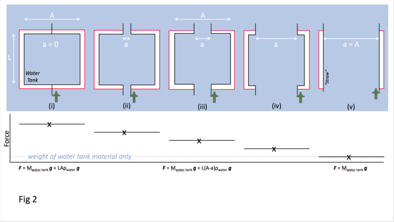

What I'm saying, to be more precise, is that the green guy exerts an upward force given by:
$$F=M_{water\ tank}g+L(W-w)\rho_{water}g$$where w is the width of the tube opening (where the water is present in each tube). In this way, only when W = w (the tank width is equal to the tube width), ##F=M_{water\ tank}g##, but otherwise, no.
  • #33
@sophiecentaur Suppose that you determined the upward force that the green guy exerts by applying a simple static force balance to the solid assembly consisting of the water tank metal shell and connected inlet and outlet tubes, and you got a different result than you obtained from what you had believed to be a proper application of Archimedes principle. What would conclude? What would be your next step?
  • #34
Chestermiller said:
I don't think we are on the same wavelength.
We certainly weren't but that statement (thank you) gave me the required kick up the backside to thing about the situation properly.
Obviously (now!) the upwards force in the water tank is less than the downwards force because of the pressure difference. The water in the tank is only 'supported' by the air pressure difference which is tiny. etc. etc. . . . . the rest of what you say makes perfect sense and I have to conclude that a small enough tube will make the water tank appear to have the same weight as without the tube.

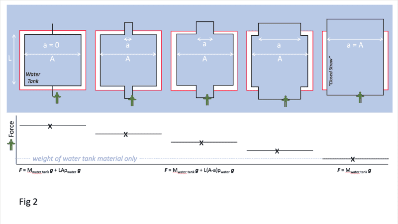

sophiecentaur said:
That's my fault for sloppy writing. In 1 I should have talked in terms of the "water tank plus the water". That could be replaced with anything of the same total weight and the air tank would still be displacing the same amount of water.
We all agree on Fig 1 as, to me, this is equivalent to the Green Man standing in a submarine lifting a jug of water. The total buoyancy is unaffected by the internal forces of lifting the jug of water and energy spent by the Green Man.
  • #36
@Chestermiller , This is your equation as relates to my original Fig 2.
F = Mwater tankg + L(A-ag
(Note, @sophiecentaur , that I changed W to A and w to a so there is no confusion with upper case and lower case fonts and to reflect 'areas' rather than '2D widths'.)
I "plotted" (more like sketched) the net force that the Green man exerts to show that it changes from lifting the total weight of the tank material plus water (water tank on the left) to the weight of the material with no water (straw on the right).
I now understand this problem and I agree (thank you @Chestermiller ).
Please see my next post (#37) as relates to my original Fig 3 with water bags isolating the hollow tubes.

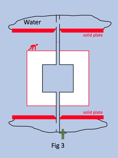

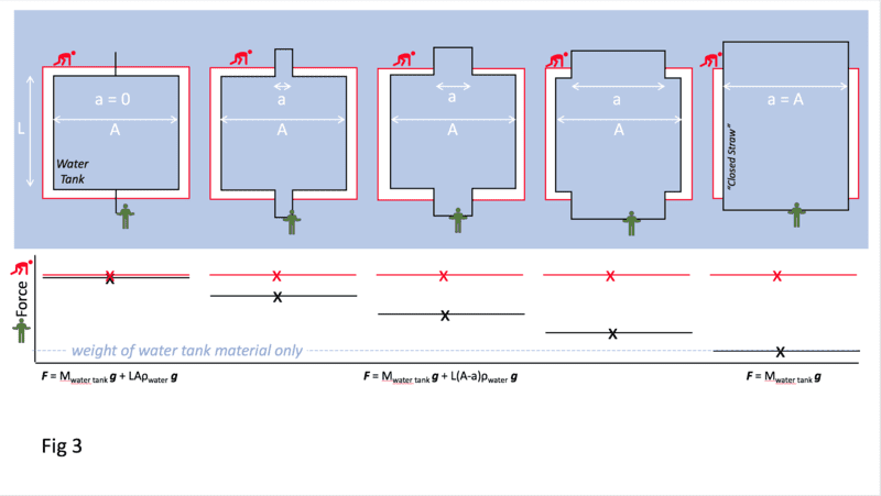

  • #37
The figure above, is my original Fig 3 reposted for clarity
In Fig 3, I isolated the hollow tubes from the outside water using the water bags. My question was "what force is the Green man exerting in each of the cases below" as the width a of the hollow tube increases from 0 to A?
The figure above with the accompanying 'sketched' plot shows my thoughts on the net force F that the Green guy exerts versus the width a of the closed hollow tube. I believe this is correct (i.e., the same results as Fig 2). Is this right?
  • #38
Also, what is the upthrust U (that the Red man must resist) on the Air Tank in #37?
Personally, I think it is a constant equal to the volume of water that the Air Tank displaces
U = LAir Tank . AAir Tankwaterg
if you assume that the Air tank dimensions are LAir Tank by AAir Tank.
Or am I counting the volume contributions of air tank and water tank twice (ref @kuruman where we must either include the volume and weight of the water everywhere or we must exclude the volume and weight of the water everywhere)?
Also, since I assumed that the relation between the Air Tank and the Water Tank is frictionless and water tight, then the net upwards force on the Air tank and Water Tank together must be equal to the difference in the two forces on my plot (actually the sum but taking into account that they are in opposite directions).
  • #39
I get that the downward force that the red guy must exert is $$F=L(A_{air\ tank}-a)\rho_{water}g-M_{air\ tank}g$$Does this make sense?
