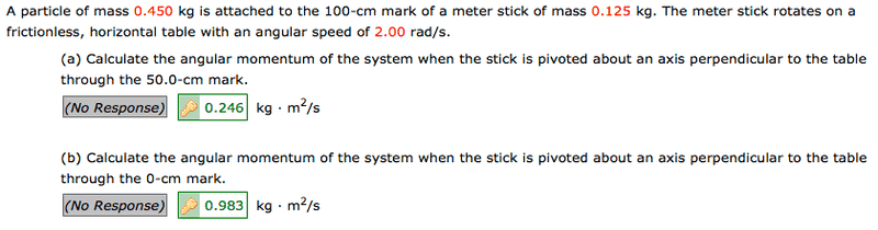

Calculate angular momentum? I almost got the right answer but it's wrong! Help!
This is what I did for part a...
1. What is given
Particle
mp = 0.450 kg
ω = 2.00 rad/s
r = 1 m
Stick
ms = 0.125 kg
ω = 2.00 rad/s
r = 0.5 m
2. Angular momentum is conserved (Linitial = Lfinal) due to a lack of friction
0 = Lfinal
L = Iω
L = (mr2
L = (0.450 + 0.125)(0.52)(2)
L = (0.575)(0.25)(2)
L = 0.2875
Help!
The formula you use for I is only good for a point mass. For a distributed mass (the meter stick) you must use a different formula, see,
http://www.physics.uoguelph.ca/tutorials/torque/Q.torque.inertia.html
and use the appropriate formulas for the slender rod.
So I_total = I_meter stick + I_mass
0 = Lfinal
?? This problem does not involve conservation of angular momentum.
L = Iω
L = (mr2
You need to find the moment of inertia of the stick either by calculation using calculus or by consulting a table.
