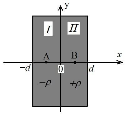

Two large uniformly charged slabs, I and II, are stacked together as shown in the picture. Suppose the thickness of each slab is d= 0.2 μm. The volume charge densities in the negatively charged slab (I) and the positively charged slab (II) are −ρ and +ρ, respectively, with ρ = 8×10−3 C/cm3. The origin of the x-axis (i.e., x = 0) is at the interface of the two slabs. Suppose the slabs extend to infinity in the y and z-directions.
Using Gauss' law, the electric field outside of the two slabs region is: 0 N/C (this answer i got rite: E=pD/2e0 - pD/2e0= 0N/C
Apply Gauss' law to slab I to find the strength of the electric field at point A at position x=-0.199 μm?
Apply Gauss' law to slab II to find the strength of the electric field at point B at position x=0.101 μm?
E (outside) = += pD/2e0 where e0=9x10^-12
E(inside)=pd/e0-E(outside) - not sure about this equation i derived
E(inside) at point A = pd/e0-(-pd/2e0)= 3pd/2e0
still not sure how to find d (it's different from D, i think.)
plaese help me with this. i have a quiz on this tomorrow >.>

Not quite sure what you're doing here. Just apply Gauss's law. What would be your Gaussian surface? (You've correctly found that the field outside the slabs is zero.)

OK, assuming one side is outside the slab and the other is at the point of interest.
So what does EA equal? I assume this is for the surface outside the slab.

You already determined that the field outside is zero. Use that fact.
well i mean the field outside both slabs is zero, but is that the same as the field outside the left slab? so that leaves pd/e0.

The thickness of your Gaussian region is the distance between the edge of the slab and the point A. You are given all that you need to calculate that distance.

d-x= 0.2 μm-0.199 μm = 1x10^-9 m
this is rite?

Yes, that is right.
ok can you help me with 1 last thing? the answer is given as 9.05×10^5 N/C for x=-0.199 μm
i did (8*10^-3 C/cm3)(1*10^-9m)/(9x10^-12) and got 0.88 N/C. and i figured out to get the correct answer i need to multiply my answer by 10^6 (this is same for part 2 also), any idea why this is?

You need to convert the charge density to standard units, C/m3. That will give you a factor of 10^6.
