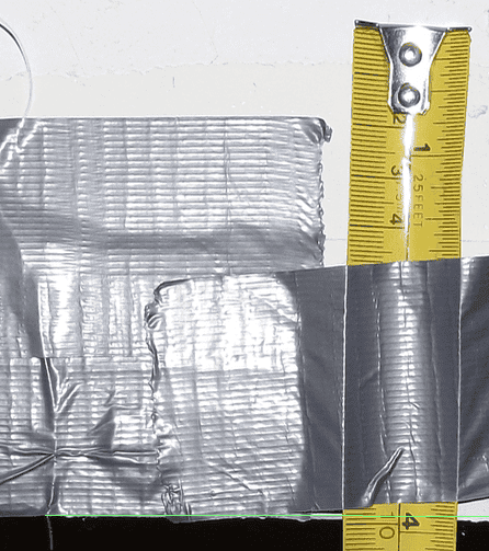

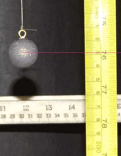

Ugh!
The batteries in my camera just died, and I think it will take a couple of hours to recharge them.
Anyways, here are the results of this mornings experiment:
Length: 1.831 m
and
cycles: 59
time: 2:40.10 (m:sec) = 160.1 sec
g: 9.817 m/s^2

Wow so that is like really close to the 'official' g. So also the amount of periods (cycles) really matter. Well actually I start to believe like every single thing matters in this.
The thing I am still wondering about. I thought the mass would be a very important thing to calculate g. So I was kinda suprised when mass wasn't in the formula.
